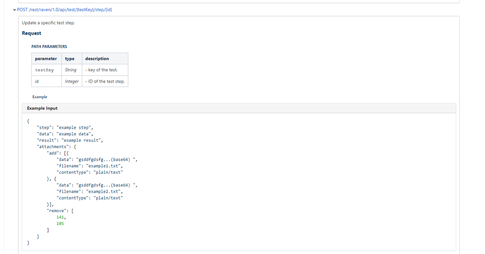

Hi @Edwin Saji Uthuppan and welcome to the community,
as far as I got XRAY documentation right the API doesn´t offer functionality to add attachment to test steps:
https://docs.getxray.app/display/XRAY/Test+Steps+-+REST
Best
Stefan
Hi @Stefan Salzl
Thanks for the reply!

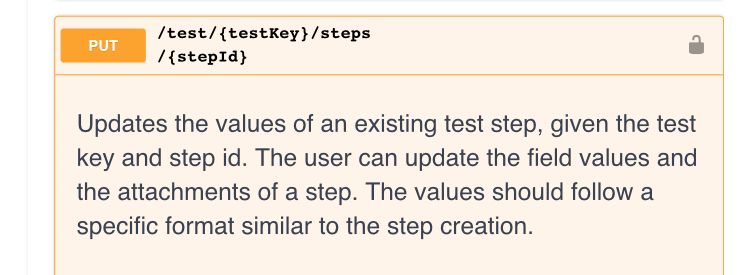

Look at the above section: It looks like it supports addition of attachments.
There are two issues though, the request has been incorrectly marked as POST instead of PUT and additionally the fact that it doesn't actually work! If you look at the response messages i am getting it doesn't look like there is an issue in recognising my request, but there is an issue in processing my request.
I will try to contact Xpand-IT, but i have to go through a lot of bureaucracy at my company... which is taking time XD
I found the docu correctly as PUT:

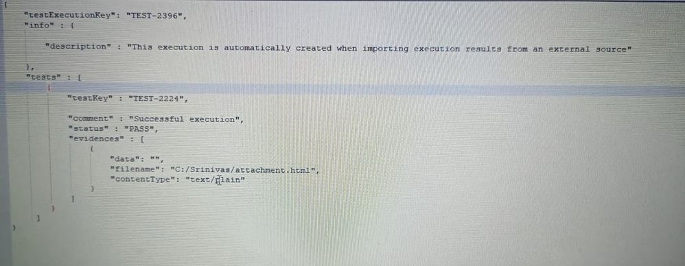

Can we add evidence for the test under test execution.
Evidence can be either html/txt file.
If yes what count be End point,
Body for the same?
Method : POST
url: jiraserver/rest/raven/1.0/import/execution
what to provide in data field. in documentation it shows some random alphanumeric values
