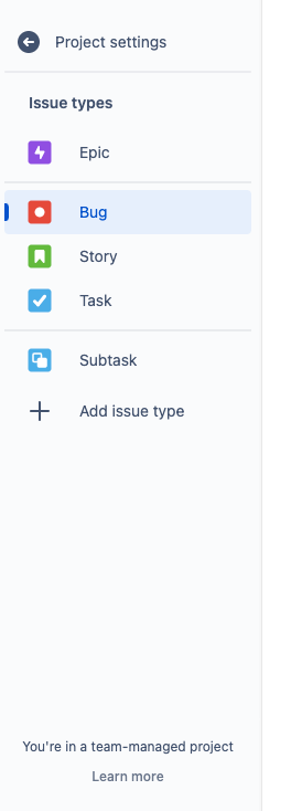

This image you provided
https://imgur.com/9Yeg18P
...tells me that you are using a Team Managed project. You can confirm that by looking at the bottom of that panel where it will say either "team-managed" or "company-managed".
With Team Managed projects you actually cannot add multiple types of Subtasks.
In that image if you click on Issue Types you will see the types of issues available in your project. Here is an example:
While you can add issue types to this type of project, you can only add at the middle level where you see Bug, Story, and Task, in my example image.
For more information about managing issue types in Team Managed projects refer to:
https://support.atlassian.com/jira-software-cloud/docs/set-up-issue-types-in-team-managed-projects/

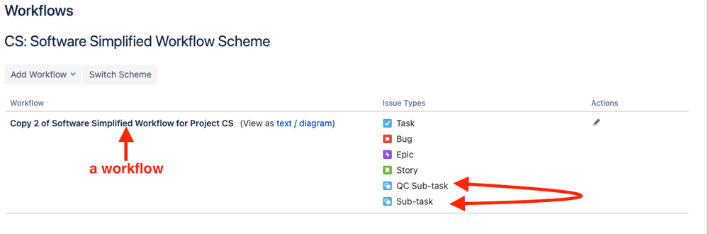

Trudy Claspill
June 26, 2023
Hello @BenWade
With regard to the question about workflows, go to your Project Settings and select the Workflows option.
Do you see the two subtask types listed for the same workflow, similar to what is shown here?
