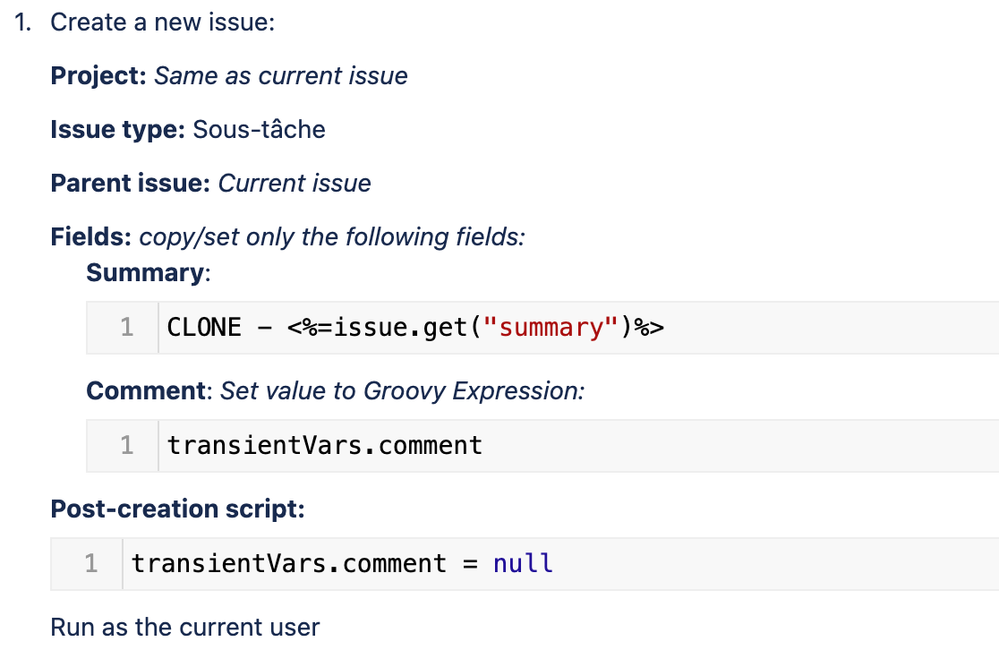

Hi @jira_admin_cu
you can use a JMWE Create Issue(s) post-function with this configuration:
This will create the comment on the newly created issue and prevent the comment from being added to the current issue.
Of course, you'll need to adjust the configuration to create the issue in the right project and copy the appropriate fields, but you get the idea.

Thank you @David Fischer , I tried using one part of the solution you suggested.
The Solution for this is :
 Post function 1 :  Used  script runner post function "Clones an issue, and links" , to create a linked issue in other project based on the field value on the transition screen.
Post function 2 : Added JMWE post function "Comment Issue Post Functions" , to copy the comment field to related issue.
In this 2nd post function, I added "transientVars.comment" to the "Comment Text"
Its working, but adding the comment on both main and linked ticket.
