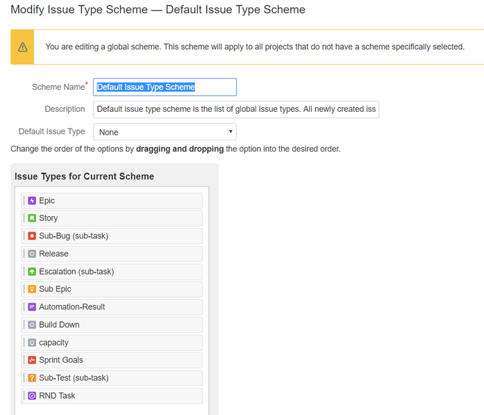

Add to the "Default Issue Type Scheme" costume issueType or remove an issueType - not working
Yakir Giladi
April 10, 2018
Add to the "Default Issue Type Scheme" costume issueType or remove an issueType - working
Thomas Schlegel
April 10, 2018
Hi @Yakir Giladi,
that's true, you can't edit the default issue type scheme. This scheme includes all the issue types defined in your Jira instance.
If you need a custom issue type scheme, you have to create a new one.

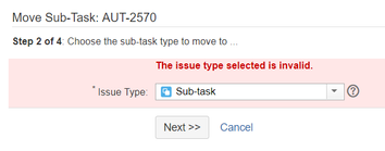

OK i want to move an issue to costume issue and i got this:
Yakir Giladi
April 10, 2018
Sorry but i tried it and it's not working

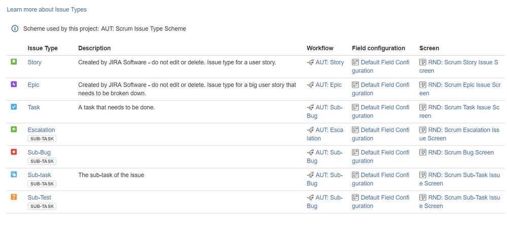

ok, could you please post a screenshot of the issue type scheme that is assigned to the AUT-Project?
Yakir Giladi
April 10, 2018
Thomas Schlegel
April 10, 2018
Thank you, but I'm sorry, I got another question: what's the current issue type of the issue you wanted to change to Sub-task? Is it already in the AUT-Project?
Yakir Giladi
April 10, 2018
yes, we are talking on moving in the same project
Thomas Schlegel
April 10, 2018
Are you able to change the type to another sub-task-type (escalation, sub-bug or sub-test) ?
Once, we had a problem with a main issue type that we accidentally called "sub-task". The project template treated our sub-task-type as a main issue type and a sub issue type, so we had somehow a standard type as subtype of another standard type. This led to really big problems in the generated project.
Maybe you got something similar.

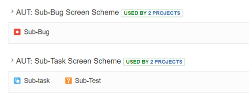

Do they have the same fields on their screens?
Yakir Giladi
April 11, 2018
They aren't, but i can move from Sub-Bug to Sub-Test
