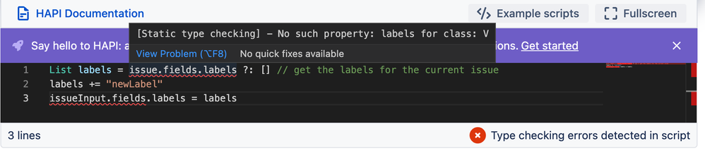

K Vivek Rao
May 4, 2025
Thank you @Piyush Annadate _ACE Pune_  for your input, but i am getting the error as attached. I am configuring it as a part of post-function on In Progress transition.
If issue is moved to In progress state, a label "test" should be added under lables, it should append not replacing.
May 4, 2025
Hi,
With post function, you can just added as below:
issueInput.update.labels = [[set: ["example"]]] // to set just the value.
Else
List<String> labels = Issues.getByKey(issue.key).getLabels()?.collect { it.label } ?: [] // get the labels for the current issue
labels += "updateLabel"
issueInput.fields.labels = labels
With error, save and test.
