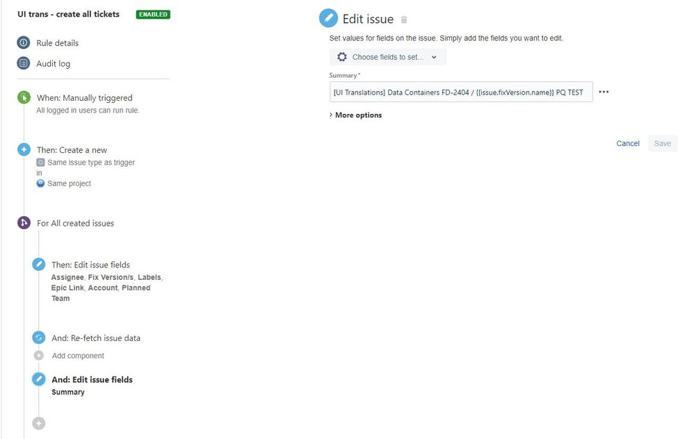

What I want to achieve with the automation: create several new issues from one. The new issues will copy most of the values from the trigger issue, with some differences.
My problem: {{issue.fixVersion.name}} won't appear in the issue Summary.
Basically, I want the automation rule to look at the fix version of the trigger issue and to copy that value into my new issues Summaries.
What my rule looks like atm:

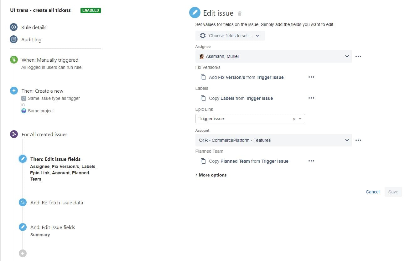

Note 1: I added "For all created issues" branching node because otherwise it was changing my trigger issue.
Note 2: I added "Re-fetch issue data" because I thought that would make the automation to re-fetch the fix version value, but it didn't seem to do anything.

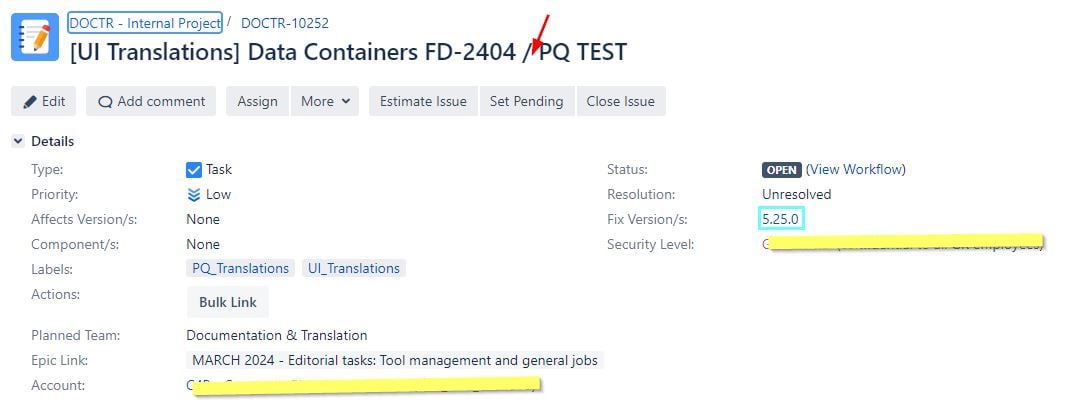

Here's what my trigger issue looks like:
And here's what the rule is returning, with the arrow pointing to where I'd like the fix version value to appear:

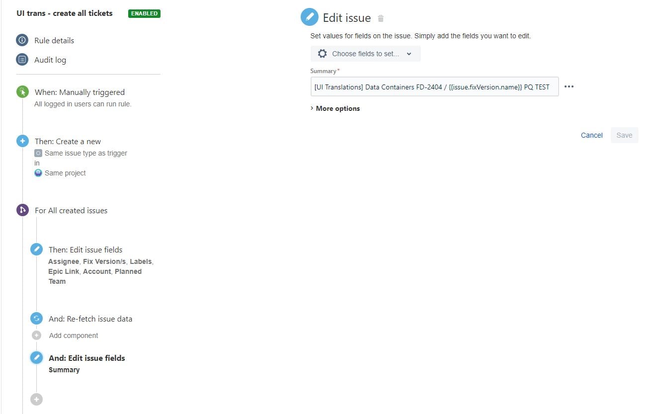

Hello @Muriel Assmann ~ I believe the correct syntax is {{issue.fixVersions.name}}.

Muriel Assmann
March 25, 2024
@Laurie Sciutti You're right, the "s" was missing
In my defense, I find Jira's smart values page a bit misleading in this regard, as it literally states "{{issue.fixVersion.name}}", without the "s".

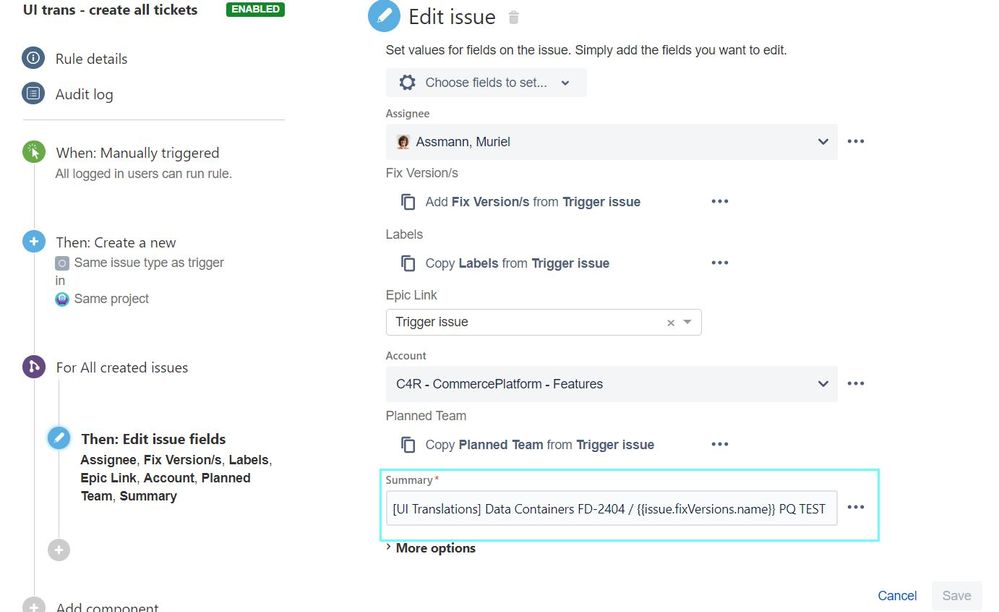

If I set the summary change together with the other changes, it simply doesn't work. I believe that the automation has to re-fetch the issue data beforehand in order to change the summary... Any idea why? So the following config doesn't yield the desired result:
Also, I tried setting up all the changes together with issue creation, but that ended up changing the trigger issue itself; which I really don't understand why. But that's why I ended up adding the "edit issue fields" rule...

Hmmm...that is quite odd.  Here is the rule I was suggesting:
  • trigger: manual
  • action: create new issue, setting fields as needed and copying others from the {{triggerIssue}}
Without seeing the exact rule action (and audit log details) it is difficult to learn why that would not work for your rule.
