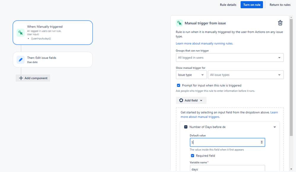

There is another workaround, if you want to trigger change manually - you can select "Manually triggered" rule, and show field to input required number of days there.
Thanks for the replies. I will try make it more clear to understand, though I think manual trigger might also be an option for this as shown above by @EvgeniiEssentially, I would like for the due date to be automatically populated based on the start date. I have a pre-defined timeframes for how long an issue should take (they will differ, some should take 3 days, some 5 days etc.), so I would need separate rules for each issue to say e.g. for this issue, due date should be set to 5 days from the start date, for another issue it might be 3 days from the start date etc.
