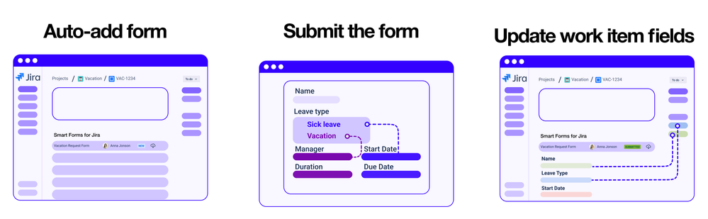

Another approach you might consider — using Smart Forms for Jira (app developed by my team)
If your goal is specifically auto-attaching a form after a transition without consuming Jira Automation runs, Smart Forms can handle that automatically at the project/issue-type level.auto add.png
Auto-attach forms without Jira Automation
You can configure a form so it appears on the issue as soon as it is created — even if the issue is created by n8n or another integration.
This avoids the need for Automation rules altogether:
Setup:
Smart Forms → Settings → Add to issues automatically → select project + issue type.
Once enabled, the form just appears on every issue of that type — no rules consumed.
Since Smart Forms allows you to update issue status after submission, you can even chain workflows without automation rules.
