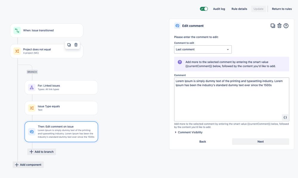

Murat Seven
December 26, 2024
Hi @Mirja Baig and thanks for your question.
I didn't quite understand why you want to update the comment in the linked project. However, you can achieve this with an automation like the one below.

Murat Seven
December 26, 2024
@Mirja Baig ,
You can also write the following smart value in the comment action:
The status of {{triggerIssue.key}} has been updated from {{#changelog.status}}*{{fromString}}*{{/}} to {{#changelog.status}}*{{toString}}*{{/}}
