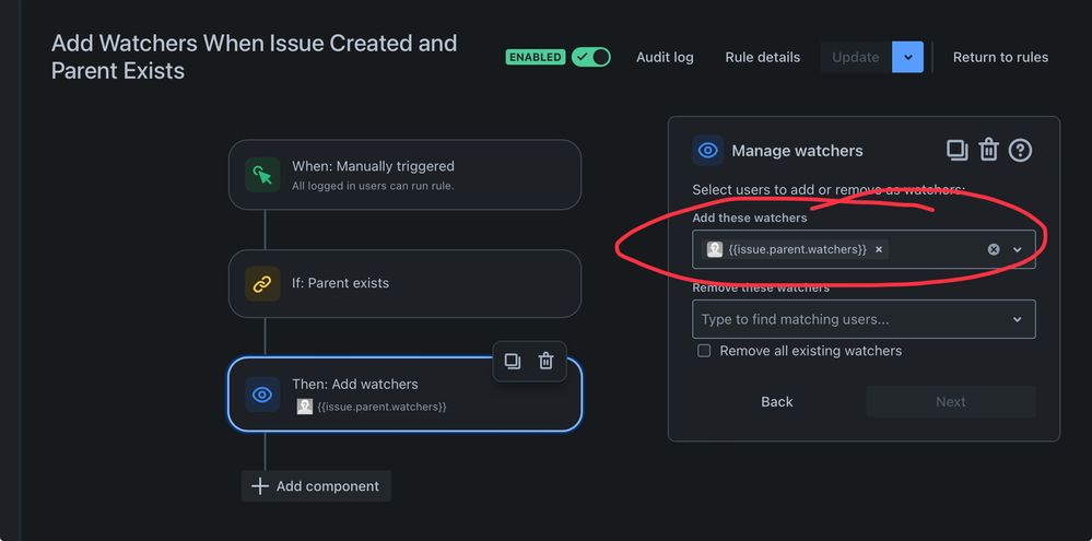

That is possible. I have created a rule like this:

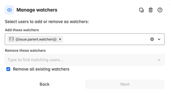

When an issue is created it checks whether it is a Task in this case and then removes the watchers that are already on the created Task + Adds the ones from the parent:
Using this Smartvalue:
{{issue.parent.watchers}}
More info on the Smartvalues can be found here:
https://support.atlassian.com/cloud-automation/docs/jira-smart-values-issues/
Using this you can easily fine-tune to your usecase.
