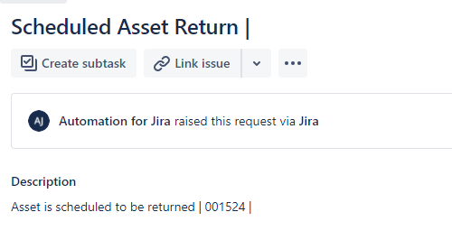

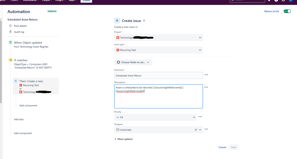

Trying to add object details from Insight to an automation rule but it does not appear I have the right query.
The rule works but I was hoping to add the asset name and model in the description. I was hoping to add the assigned user to the summary field.
Hi @James Calimutan ,
I'm Nithaya from the Automation team at Atlassian. Since you used an Insight object trigger, you cannot use the format {{issue.(custom field name).(attribute name)}} because there is no issue triggered in your rule.
But you can access to the object attributes by using this format: {{object.(attribute name)}}
In your case, it should look like this: {{object.name}}, {{object.model}}, {{object.user}}

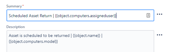

Need help with the correct attributes to use. The below only pulls up the name of the asset and nothing else. I was hoping to get the Assigned User in the Summary and the Name and Model in the Description. Thanks in advance,
Hi @James Calimutan - Without visibility into your schema, you should be using the following values:
{{object.<object type where your reference data is stored (e.g. Users)>.<attribute you're trying to bring in (e.g. Name)}}

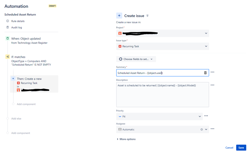

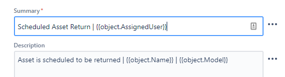

Thanks @Mark Segall - still not there yet. Not sure if I did your recommendation correctly.
Hey @James Calimutan !
Did you manage to display anything? From what I see, the names of your attributes and references start with uppercase letters. I think that smart values are mostly case-sensitives.
Cheers,
Nithaya.

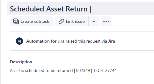

Hi @Nithaya
I removed computers from the syntax as that would not return anything. This is the syntax now. I still cannot get the Assigned User field to show up. The result for model is the key and not the actual model not sure why.

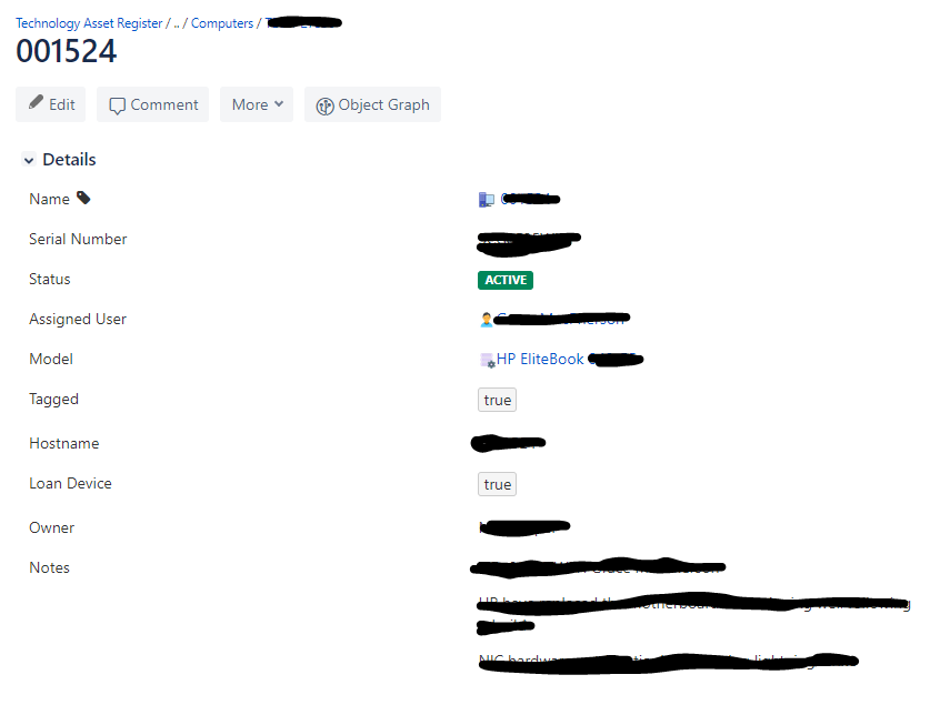

I see! Since the attribute "Model" is an object reference, you need to use: {{object.Model.(the attribute name to get the model name)}}
As for the attribute "Assigned user", you need to type {{object.Assigned User}} with the space in between.
Let me know if it works!
Cheers,
Nithaya.

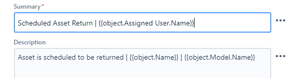

Success! Got it using the syntax below. Thanks @Nithaya and @Mark Segall for all your help!
