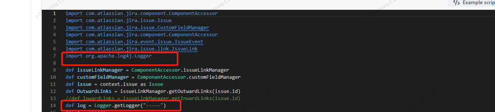

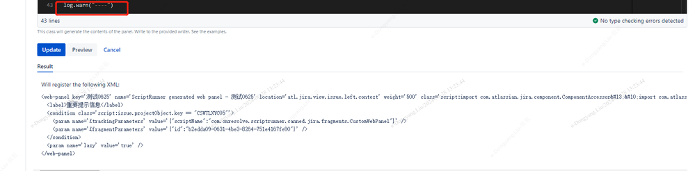

Log. warn cannot be used for log output in the Provider class/script of the Show a web panel module in Fragments

e-Dongyang.Liu
June 27, 2024
I added the log variable, but it still cannot be printed. Please confirm if it is a bug!导入包.png输出.png
