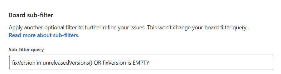

The option to hide completed items older than a certain date applies that criteria to the Updated timestamp rather than the Resolved timestamp. Adding the issues to a Release would change the Updated timestamp.
On the same board settings page where you find the option to hide completed issues you should see the board filter listed and you should see Board sub-filter. If it is set as shown below, then issues associated with a Released Version should also be hidden from the board (regardless of the issue's status).

Hello Trudy, thanks a lot.
That filter was set (as that seems to be the default), but it was the unreleasedVersions() which messed it up.
Thanks again!
