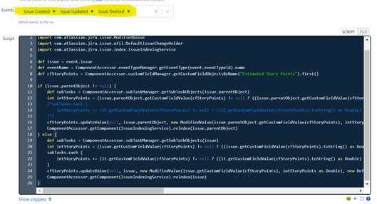

Hi @siva,
I changed the code as follows:
import com.atlassian.jira.component.ComponentAccessor
import com.atlassian.jira.issue.ModifiedValue
import com.atlassian.jira.issue.util.DefaultIssueChangeHolder
import com.atlassian.jira.issue.index.IssueIndexingService
def issue = event.issue
def eventName = ComponentAccessor.eventTypeManager.getEventType(event.eventTypeId).name
def cfStoryPoints = ComponentAccessor.customFieldManager.getCustomFieldObjectsByName("Estimated Story Points").first()
if (issue.parentObject != null) {
def subTasks = ComponentAccessor.subTaskManager.getSubTaskObjects(issue.parentObject)
int intStoryPoints = (issue.parentObject.getCustomFieldValue(cfStoryPoints) != null ? ((issue.parentObject.getCustomFieldValue(cfStoryPoints).toString() as Double) as Integer) : 0) + (eventName == "Issue Created" ? (issue.getCustomFieldValue(cfStoryPoints) != null ? ((issue.getCustomFieldValue(cfStoryPoints).toString() as Double) as Integer) : 0) : 0)
/*subTasks.each {
intStoryPoints += (it.getCustomFieldValue(cfStoryPoints) != null ? ((it.getCustomFieldValue(cfStoryPoints).toString() as Double) as Integer) : 0)
cfStoryPoints.updateValue(null, issue.parentObject, new ModifiedValue(issue.parentObject.getCustomFieldValue(cfStoryPoints), intStoryPoints as Double), new DefaultIssueChangeHolder())
ComponentAccessor.getComponent(IssueIndexingService).reIndex(issue.parentObject)
} else {
def subTasks = ComponentAccessor.subTaskManager.getSubTaskObjects(issue)
int intStoryPoints = (issue.getCustomFieldValue(cfStoryPoints) != null ? ((issue.getCustomFieldValue(cfStoryPoints).toString() as Double) as Integer) : 0)
subTasks.each {
cfStoryPoints.updateValue(null, issue, new ModifiedValue(issue.getCustomFieldValue(cfStoryPoints), intStoryPoints as Double), new DefaultIssueChangeHolder())
ComponentAccessor.getComponent(IssueIndexingService).reIndex(issue)
Check if it's ok for you.
siva
June 27, 2022
@Andrea Pannitti
Tested the above script this also performed like previous script calculates the all subtask story points again when 2nd subtask created.
Once again will explain it
I had created issue story and story point was 2 under story created subtask-1  and story point is 1. So far the script working fine it calculated 2+1=3.
Now this time created 2nd subtask-2  and story point is 2 now suppose to calculate parent + subtask-2 i.e  3+2=5.  But our script calculates parent + subtask-1 +subtask-2 i.e 3+1+2=6
Thank,
Siva
Andrea Pannitti
June 27, 2022
@siva,
I've commented out a few lines in the code above; can you check if the behavior is what you expect?
siva
June 27, 2022
@Andrea Pannitti
Thank you very much finally it start working as i expert and finally one more last modification in the script is it any possibility to update  Estimated Story Points in parent when existing subtasks story points are updated and also when subtask is deleted. As of now the present script working fine when subtask is created and also I'm attaching the screen shot how I configure the script in listener. Once again thank you very much for your help and very appreciated.
Thanks,
Siva.
