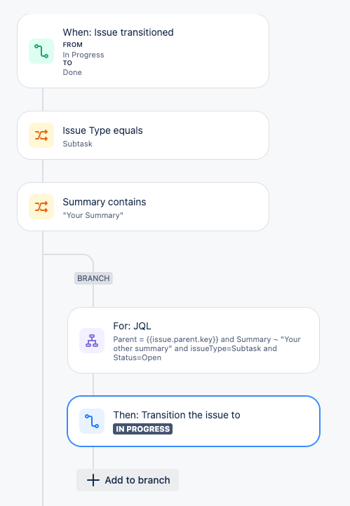

Hello @Steve Huffman
Are the Summaries for these related subtasks fixed? Will it always be that when a subtask with summary = "Generate Code Merge Sub-Task" is transitioned then you will want to transition its sibling subtask where summary = "Merge Validation Testing Sub-task"?
Will there ever be more than one subtask that contains the text of either of these Summaries?
You could accomplish this with a rule structure thus:

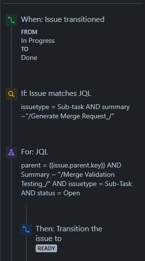

Thank you.  This got me much closer than I was when I started.  I can get the above to execute, but it is not changing the status of the secondary sub-task.  Below is what I set up.  Is there something I am missing I am not seeing?
NOTE: To answer your question regarding if the names are fixed, I am using the names as prefixes and then appending the parent name to the end.  I am using another automation to generate the two sub-tasks.
Example
- Generate Merge Request_Parent Story Name
- Merge Validation Testing_Parent Story Name
Here is my automation.

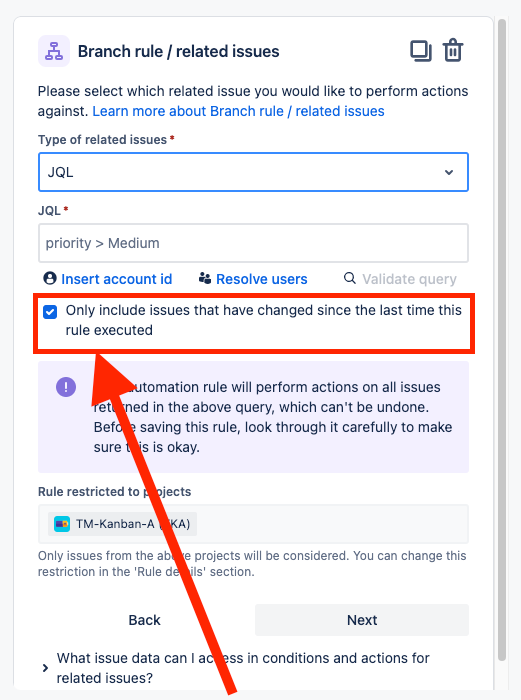

Notice the last message.
No related issues that have been updated since the last time this rule executed could be found.
When you create a For Related Issues/JQL step there is a checkbox that is checked by default that will further constrain the selected issues to only ones that have been updated since the last time the rule executed. Uncheck this box and see if that makes a difference.
Steve Huffman
January 5, 2024
That fixed it!  Thank you!!!
