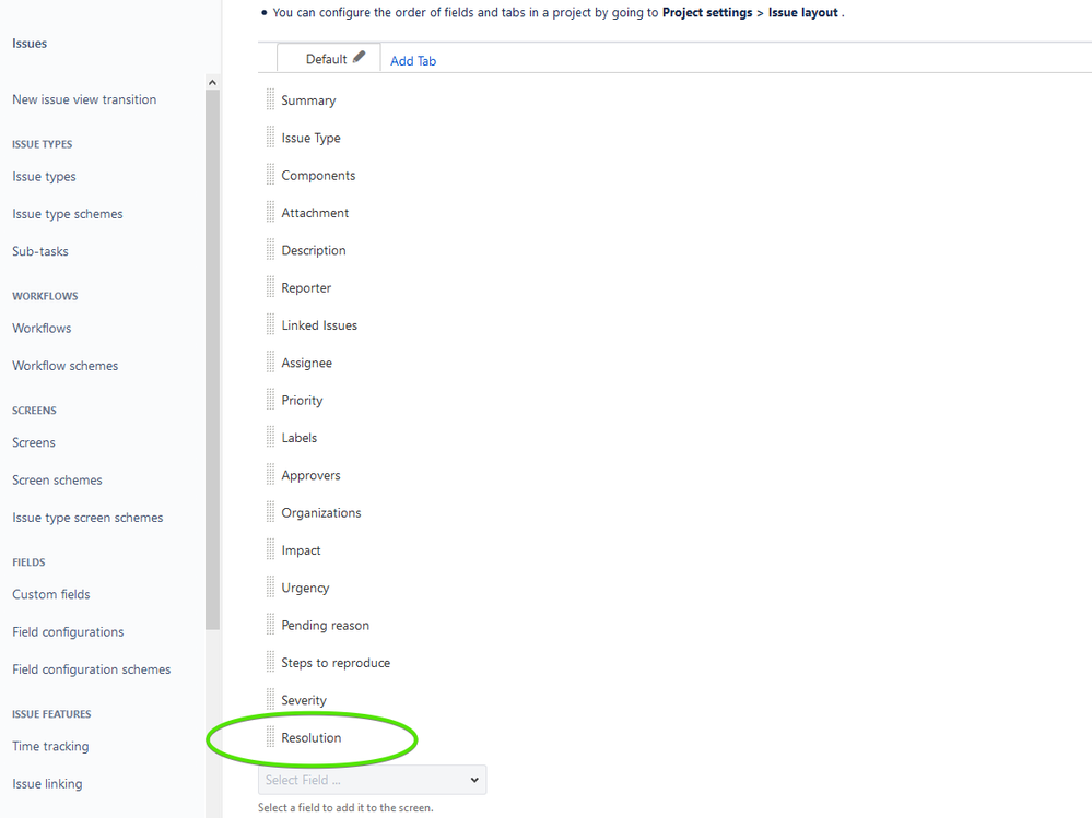

Alexey
May 5, 2021
It took a while but I've found all the necessary info. Here is a small recap in case someone will be looking for the same thing:
1.  Here is a feature request https://jira.atlassian.com/browse/JRACLOUD-69556, you are able to add a drop-down menu to edit existing resolutions if you add 'Resolution' to the issue screen
2. How to add that to the screen? Follow this guide
3. About data corruption - all you need to remember is if an issue got resolution Jira considers it as 'closed'. So as long you are changing resolution within statuses which you treat as closed you are totally fine. I
Jira designed to be flexible, and my projects have multiple resolutions for each 'final' (green) status. For instance status 'Declined' means for our teams no one been working on it and resolution is an indicator WHY i.e.: Not a bug, Duplicate, Client Declined etc.
Nic Brough -Adaptavist-
May 5, 2021
No, this is exactly what we said you should not do.  It will corrupt your data.
Again, if you put the resolution field on the edit screen, then every edit will resolve your issues.  You will be corrupting the data on every edit.  Please see my answer and last comment in the thread from the 27th April.
May 5, 2021
So you're happy to corrupt your data, have unresolved issues that are resolved?
Atlassian support did not provide you with this solution.  They will have told you what I said before - you can put the resolution on the edit screen temporarily and remove it later, before you corrupt your data.
