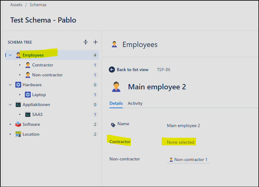

Refer to the Employees (Alpha), Non-contractor (Beta), and Contractor (Gamma) attached schema and example.

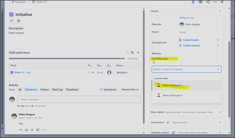

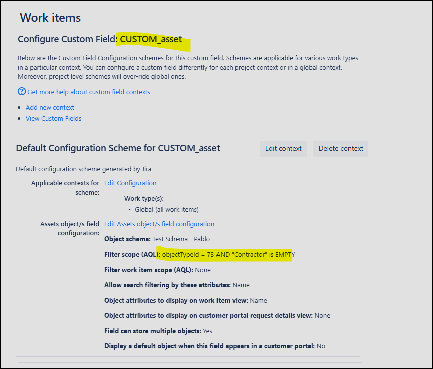

As you can see, you can filter those Alpha objects having no Gamma child objects linked up and present them in a custom asset field using AQL within the field config.
I hope this example helps you!

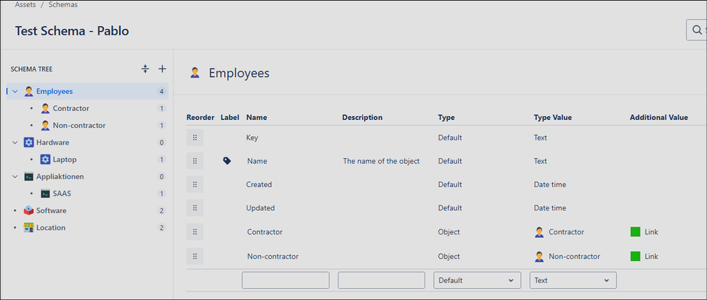

Just in case you're wondering what the link configuration is:
