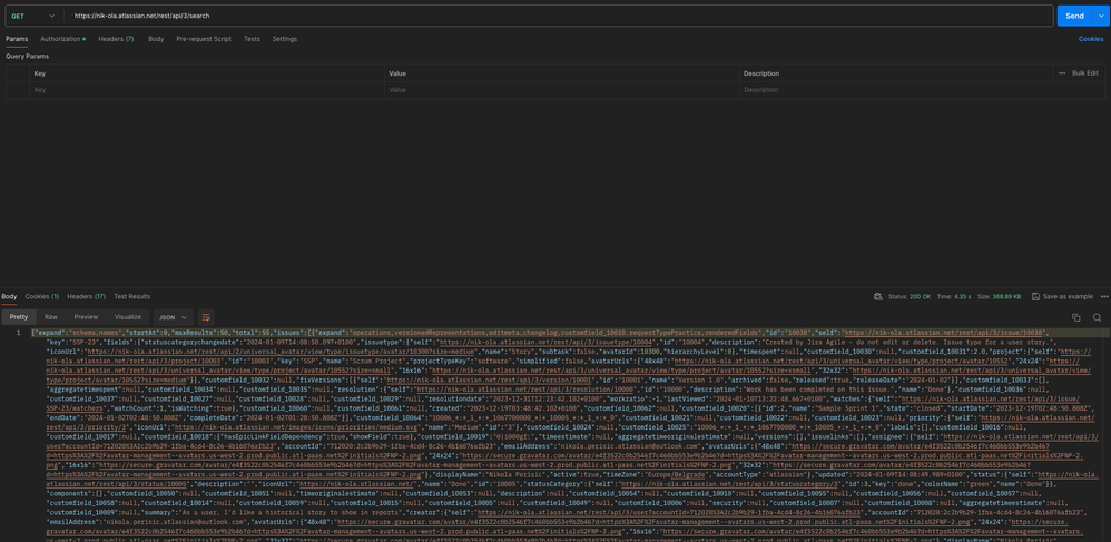

I tested with Postman, and these are the results:
This is for the first url from Postman. Check your Postman "Authentication" window, make sure that you use "Basic auth" where your password is the Jira API key.

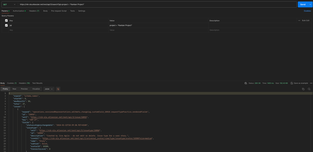

For the second url, I was also able to fetch the data:
Make sure that in your query parameters you enter jql for your key and the value the actual JQL query.
