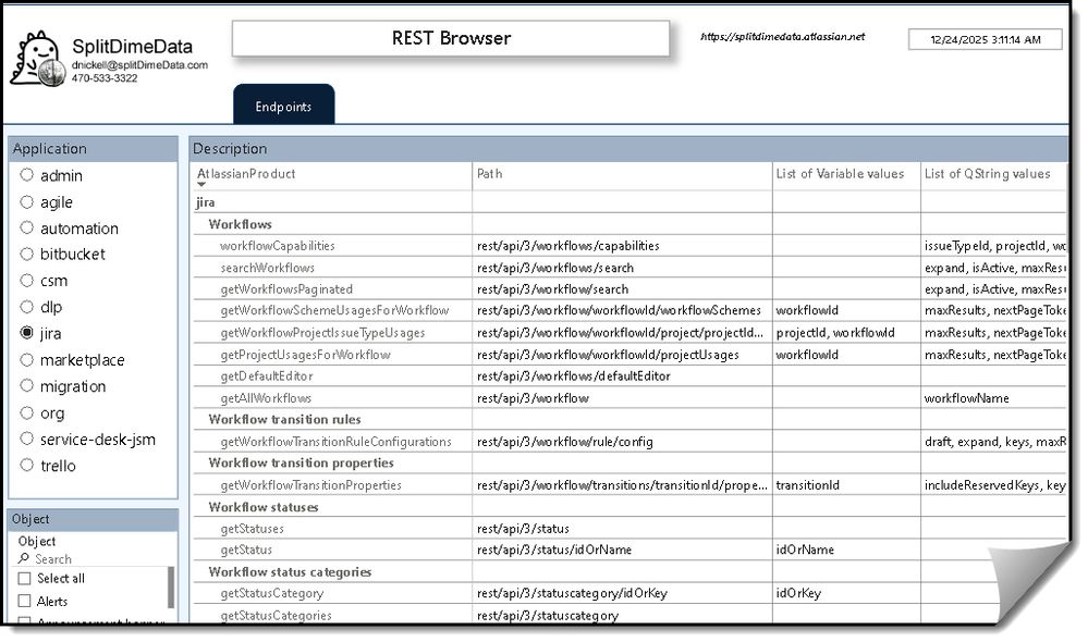

You may find this FREE PowerBI I've created useful... it uses the REST Definitions provided by Atlassian to build an Endpoint Report
REST Endpoint Browser
  • The version I am sharing has the GET endpoints only
  • There are (IMHO) three kinds of data available through REST:
    • Configuration (projects / spaces, screens, fields, etc)
    • Reference Lists (Users, Issue Types)
    • Project Data for Reporting (Ticket data, Workogs, Changelogs for metrics)
  • Your use cases require a certain amount of programming aptitude.  Many of the calls return paginated results and the keys from one call may give you the details you need for subsequent calls.  (example -- getting worklogs for an issue means getting the issue first - typically).
  • I've found using REST for Reporting and Documentation very effective.  You can, for example, get information about your configuration Real Time.  This saves on time needed to create and maintain documentation.
  • Using the Other REST Calls for actually updating your configuration is something that needs to be treated with the utmost care.  Only in extremely well tested and very defined use cases would I ever consider making the updates outside of the Atlassian UI.
If I can make this report more useful or you would like to collaborate, let me know.
