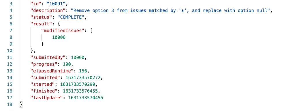

2. Called /rest/api/3/field/{fieldKey}/option/3/issue to deselect all issues with option 3 selected. As you can see below the response was already with status COMPLETE and progress 100. The modifiedIssues list show the ID of my issue correctly.
3. Called /rest/api/3/issue/SKP1-7 again, but customfield_10038 still have option 3 selected.
