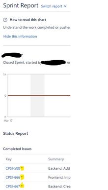

I am attempting to figure out how JIRA keeps track of what issues are associated to a sprint for the following:
  1. Issues added to a sprint after the sprint started (the asterisks) on the sprint report
  2. How do you keep track of the story points at the beginning of the sprint vs the end of the sprint
  3. And lastly how do you know if an issue was closed in a sprint or rolled over to the next sprint.
The data has to be stored somewhere because I keep coming up with different numbers, slightly different. The report I am writing is like 95% accurate there just appears to continue to be anomalies in the SQL logic.
Attempting to write a query that effectively returns
Sprint | ISSUENUM | Subject | SprintClosed | StoryPointsStartOfSprint | StoryPointsEndOfSprint | StoryPointsCompletedThisSprint | StoryPointsAddedAfterStartOfThisSprint  | StoryPointsRemovedThisSprint | StoryPointsNotCompletedThisSprint
SQL is pretty bad at this point but I think I can significantly simplify it if I can figure out where the data is rather then trying to calculate it.
