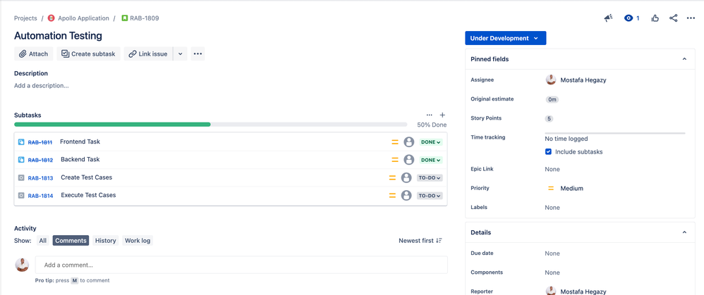

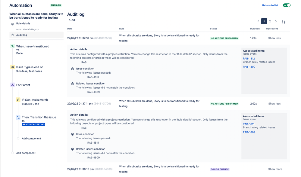

So I have a current issue with Jira's automation. I think it's a Bug.
First we have Jira's normal "Subtask", and that when I created the automation for it all goes smooth and well, as so:
However, I have created another Subtasks issue type called "Test Cases" (with it's own workflow) and when both subtasks are created within the same story, the "related issue condition" within the automation rule always fails even when I use JQL within the "related issue condition" so that I can specify exactly "Subtasks" and not "Test Cases" Subtasks , Like so:
Please let me know if you can help me with this situation or if it's a current issue within Jira

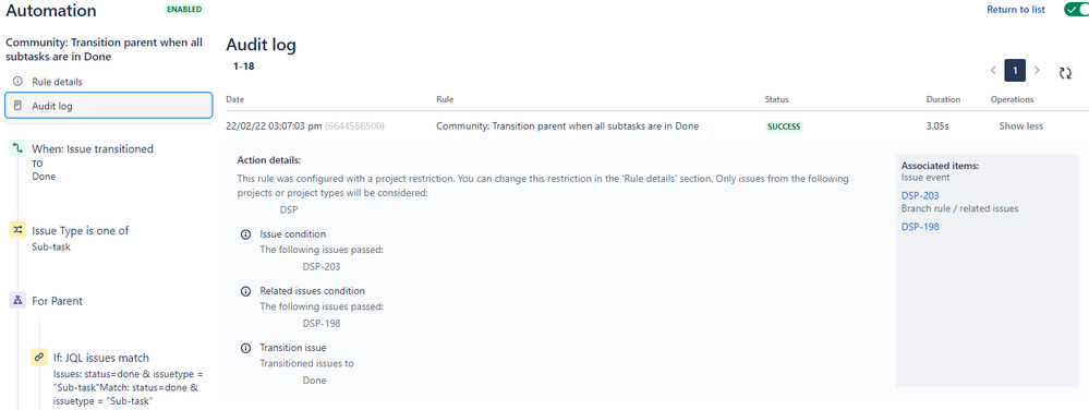

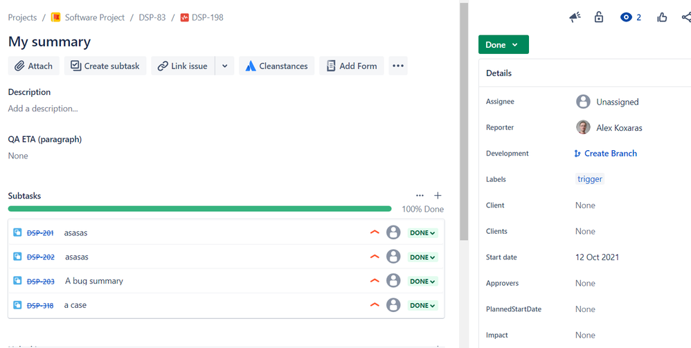

@Mostafa Hegazy hi,
I've tried your rule and it works just fine:
I've got 2 different subtask issue types. The first three are sub-tasks, whereas the fourth one is a "test case" subtask. The rule is triggered with every subtask move to done. And when I finally move the "test case" to done, it's also moves the parent.
Mostafa Hegazy
February 22, 2022
Yes this is the first scenario that goes smoothly without any issues, but if you tried creating a new subtask issue type, and adding it to the same story as that subtask, it will not work. it will fail

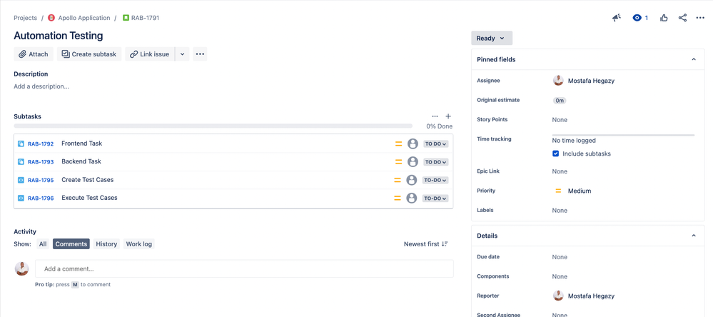

Mostafa Hegazy
February 22, 2022
I'll send you screenshot, but I don't want when all subtasks issue types are done then parent is done.
I want when ONLY "subtasks" subtask issue type is done, then parent is done.
So keep the "Test Cases" subtasks, "To-do" or "In Progress".

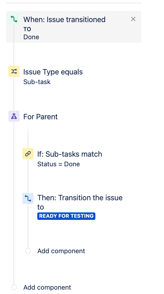

Mostafa Hegazy
February 22, 2022
So, When I change only the "Sub-tasks" subtask issue type to done, I want to change Parent to Ready for Testing.
Hence it's not suppose to be in "Related Issue Conditions": Issue type is one of Subtasks, Test Cases.
It's suppose to be only Subtasks.

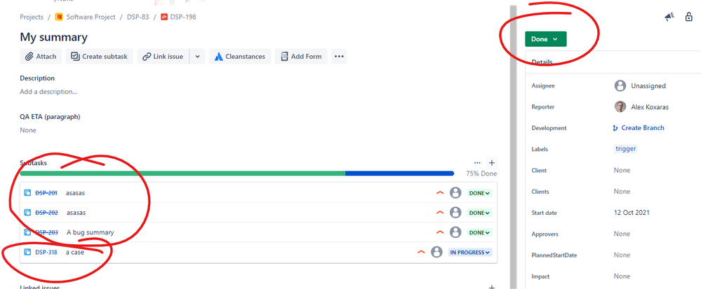

Alex Koxaras -Relational-
February 22, 2022
@Mostafa Hegazy why didn't you say so? :)
Then do this! I've tested it on my instance and only when all sub-tasks are done (not test-cases) then the parent is moved to done
Mostafa Hegazy
February 22, 2022
Thank you @Alex Koxaras -Relational-
However it worked as soon as one subtask has transitioned to "Done", I need the transition to happen as soon as both are transitioned to "Done"

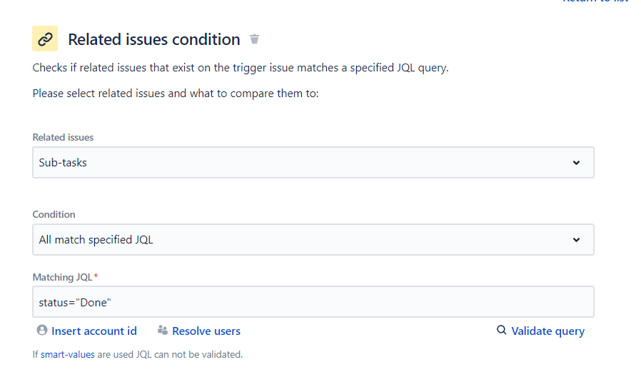

@Mostafa Hegazy ,
 In the "Related issue condition"  have you try with following parameter. In the Matching JQL -
status="DONE" only.

Mostafa Hegazy
February 21, 2022
that's exactly the first try, and it works perfectly is there is only Jira's default "Subtasks", but when I added a new subtask "Test Cases" (I created it). it always fails.
I feel like Jira can't couldn't cope with the new subtask, if it is or isn't a subtask so it just fails.
So I even created a JQL within the "Related issues" field as so:
issuetype = Sub-task AND issuetype != "Test Cases"
Still doesn't work!
