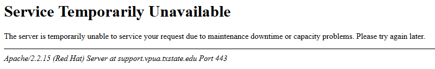

When I run Jira I get the "Service Temporarily Unavailable" error when attempting to access it through http. I discovered why it's giving the issue but I don't know how to fix it. Recently I performed a server migration of our Jira instance to new a server. I was recommended by a help article to copy over the Jira installation and home files to the new server, which I did. I reconfigured dbconfig.xml for the new server as well, but when I run Jira on the new server, I get that error. The weird part is when I run Jira on the old server the error goes away and it connects fine. I believe there is a file still pointing to the old Jira server but I have no clue as to what is.

I located the error log in /etc/httpd/logs/access_log and the file was empty. I am attaching a picture of the error just in case.firefox_2020-11-17_18-30-51.png

Is it possible the old server is causing an issue with Apache/Httpd still running?
David Stevens
November 18, 2020
I also just realized my the error mentions Apache/2.2.15 when that is the version on the old server but not the new one.
