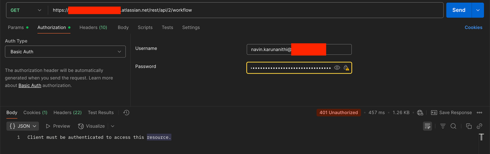

@Yogesh Mude: I tried what you suggested, by having email as the username and the token generated as the password, then performed base64 encoding. But it still return 401 error with Client must be authenticated to access this resource.
I have tried using the developer console to create an app, added scopes and then authorized it to the sandbox for which I have admin permissions. I have added the generated access token as bearer token and also tried it as basic authentication by adding it with email as the username and the token the password, then performed base64 encoding but still facing this 401 issue.
I have also tried creating an API token using https://id.atlassian.com/manage-profile/security/api-tokens selected the JIRA scopes and added required scopes to test it. For this too i have added them as bearer also as the mentioned basic authentication but it was the same.

I am getting "You are not authenticated. Authentication required to perform this operation" for api/2/statuscategory and "Client must be authenticated to access this resource" for the above mentioned objects in the post.

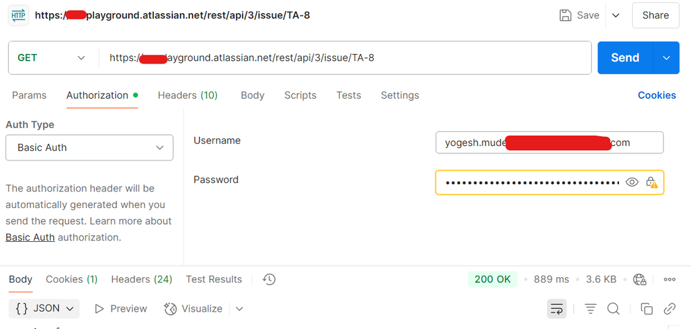

Can you try to access any single isue data as i shown in my earlier snap? and check if that success?

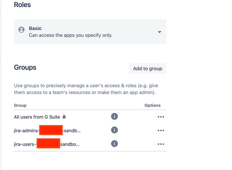

I have created a new issue in the sandbox, for which I believe I have been given admin access to. Please refer to the below image. This was the image shared to me by the person who manages Jira when asked for sandbox admin access.
Screenshot 2025-07-21 at 16-53-44 INFRA-3796 Need Admin access for Jira Sandbox - JIRA.png

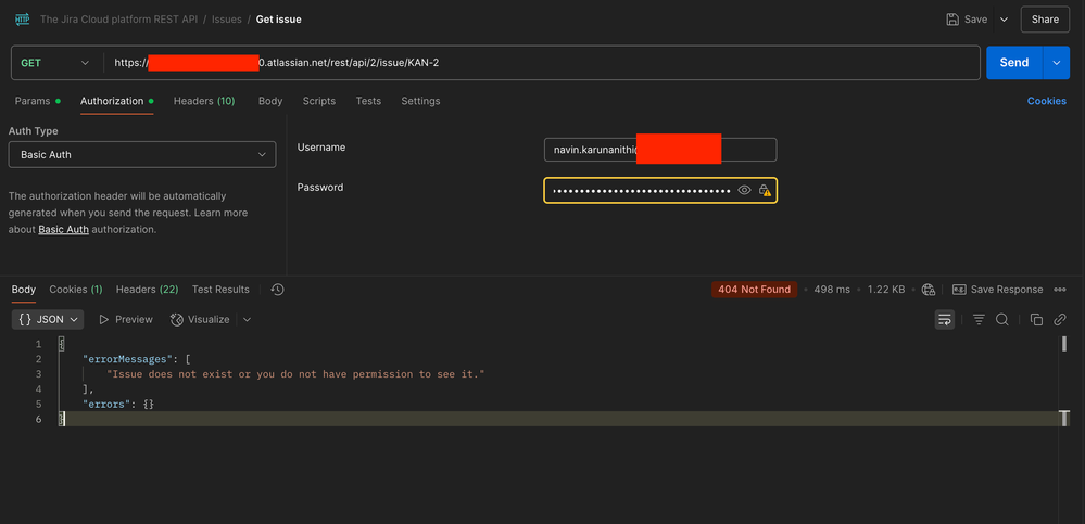

I tried to access this issue and some pre-existing issues as well, but I was not able to.

@Navin Karunanithi  Can you please check the work item you are trying to access ie KAN-2, does you have the access to that project browse work item permission and also can you ask the person to grant you jira product license so you should be added to jira-<site-name>-users group and then try.

@Yogesh MudeI am able to access the issue KAN-2 via browser directly. I can see the response has all the fields such as issue_type, project and statuscategory etc.
Yes, I do have access to the project in which this issue is present.
