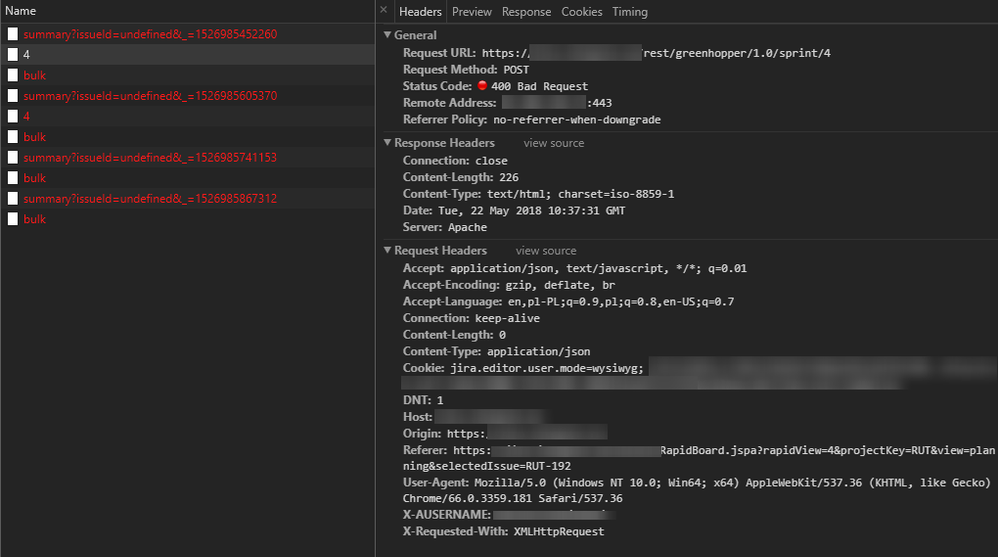

lately we started proxying our Jira instance using Apache and we noticed an error, when trying to create a new sprint. It says "error bad request".
575709037f
Here is a screenshot from chrome
6df4e33c18

I changed the scheme in server.xml as you said to https, but unfortunately, it didn't help.
I also double-checked my configuration with the tutorial you linked - it seems like everything should work fine. Here are two screenshots you asked for - with a ResponseRequest URL, Origin, and Referer.

[Mon May 28 10:15:50.131748 2018] [:error] [pid 73508] [client 50.0.0.254] ModSecurity: Access denied with code 400 (phase 2). Match of "eq 0" against "REQBODY_ERROR" required. [file "/etc/modsecurity/modsecurity.conf"] [line "62"] [id "200002"] [msg "Failed to parse request body."] [data "JSON parser error: parse error: premature EOF\\x0a"] [severity "CRITICAL"] [hostname "jira.integree.eu"] [uri "/rest/internal/1.0/licensebanner/remindlater"] [unique_id "Wwu6tn8AAQEAAR8kRYwAAAAC"]
This seems to be the problem. It is a problem with mod_security having a problem with POST requests with an empty body.
