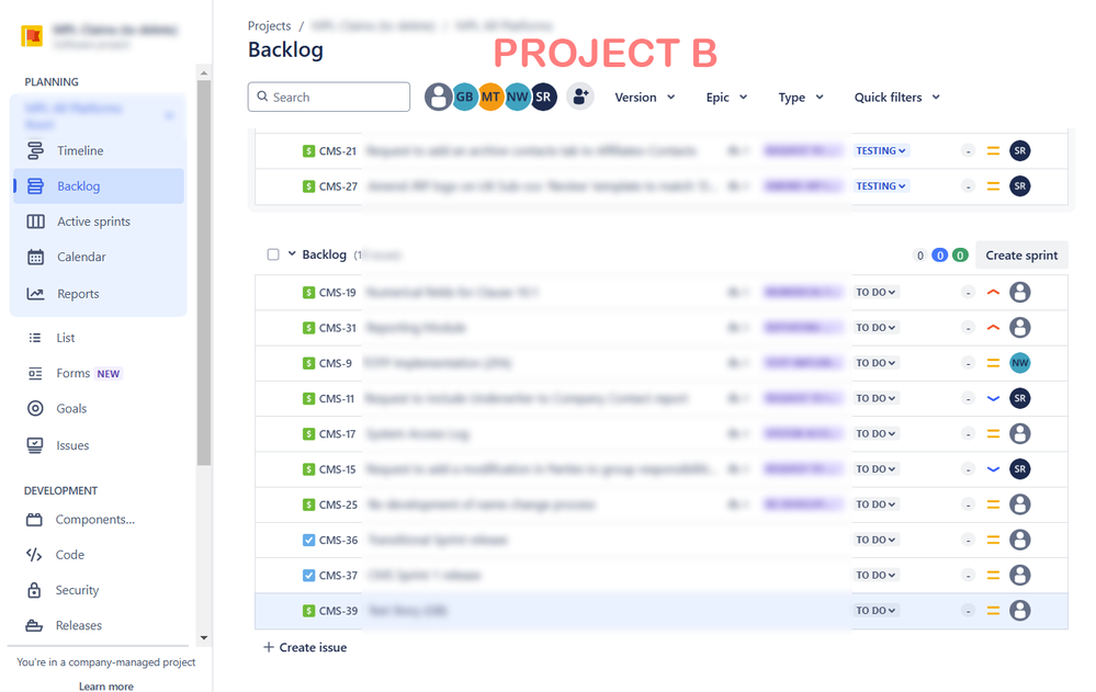

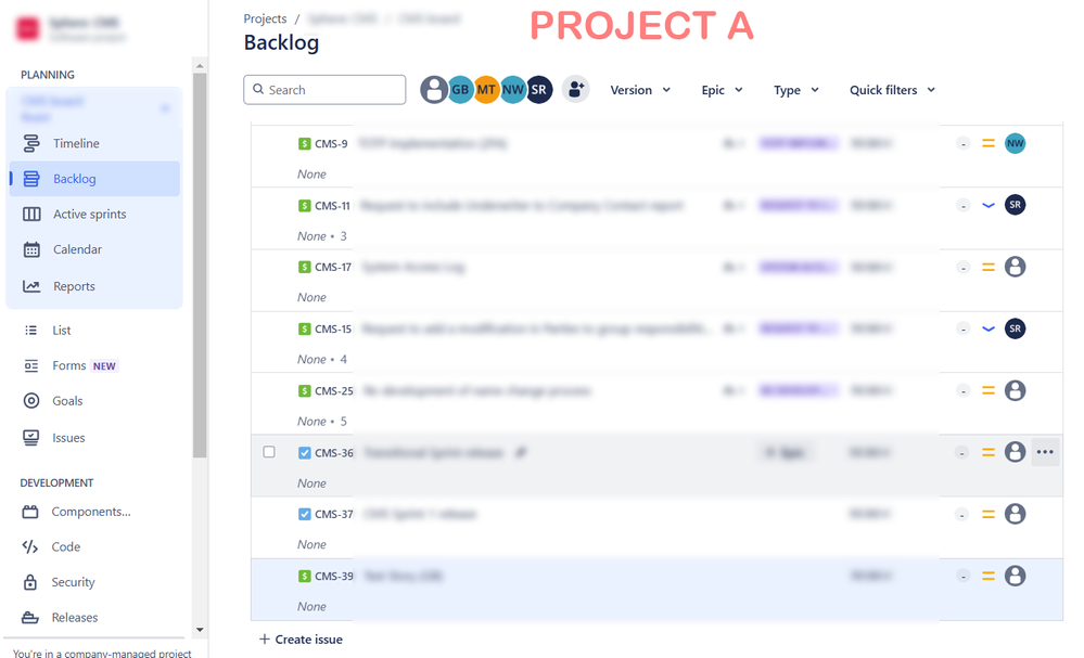

Hi there, hope you can help me.
I have 2 projects sharing exactly the same list of tickets. Whatever I do in one project can be seem in the other.
Im now conscious that if I delete project B, it will delete all items from project A as its linked to both.
How can I undo this mess? Project A needs to be kept and B can be ditched.
Thanks in advance for any advice. Cheers.

Hi @Gustavo Bunheirao,
You need to check the filter used by both of the boards, my guess is that it is too broad so that it picks up issues from both projects and that is why you see the same issues in both boards.
If you would remove project B issues that belong to that project would be removed too. It would not affect project A. You can distinguish which project an issue belongs to by looking on the issue key, the the letters before - is the project key.

Thanks Mikael, appreciate your time reviewing this.
I'll do some research regarding the filtering hypotheses but I'd say you already helped me by clarifying that the chances of losing the issues in case I delete project B wouldn't happen.
Cheers bud
