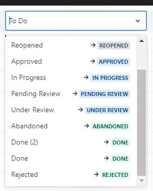

Hi there,
My project got 2 workflows but they are exactly the same, unsure how come  I got "Done" duplicated. Any suggestion on how to remove the extra one?
Thanks for sharing.
Regards
MM
CK.jpgcny.jfif

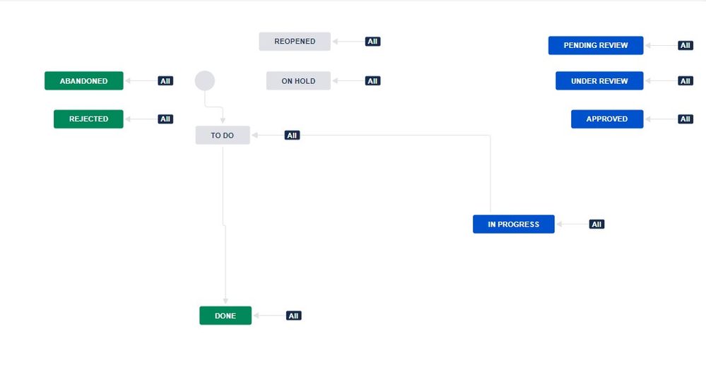

Hi Mimi,
You are using global transitions in your workflow (<--All)
Check this page-> https://support.atlassian.com/jira-cloud-administration/docs/work-with-issue-workflows/
Also then you have added a transition from To-Do to Done, i think you should delete this transition from To Do to Done

Hi @Mimi Peters , Can you confirm that this is a Company Managed Project (CMP)? Can you check if there are duplicate "Done" statuses under settings > issues > Statuses (sidebar) defined in your instance?
Mimi Peters
February 14, 2023
It’s a CMP, indeed I got one extra point to Dome status , once I remove it and it’s all good :)
