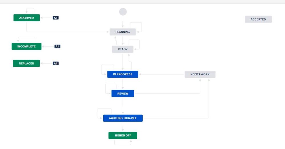

I wish to simplify the issue transitions for one of my boards. At the moment each issue has to progress through many transitions before reaching Done. I wish to have fewer transitions for one of my boards (e.g. Planning, In Progress, Review, Signed Off, Incomplete, Archived) transitions for each issue type instead.  Is this possible?

The workflow in your screenshot looks very linear, so if you remove a status on your board, then you will not be able to move the issue through the columns by dragging it.

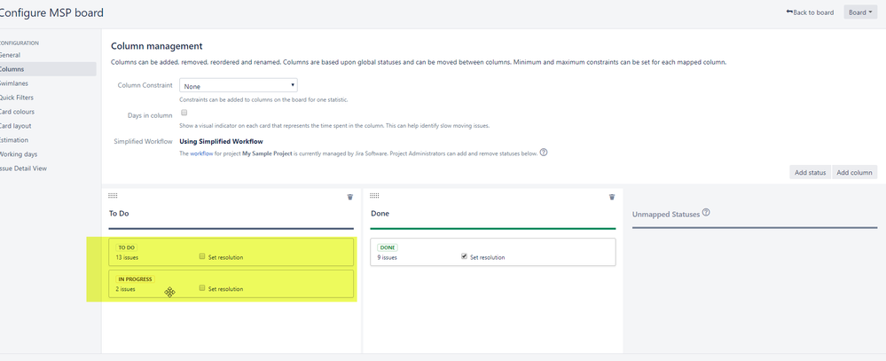

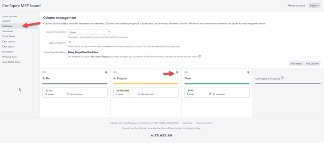

If I understand your question correctly, this is absolutely possible. Go into the board configuration and then go to Columns. As you can see in the board below, I have 3 columns and 3 statuses. Delete the column you dont want and then the status will be unmapped.

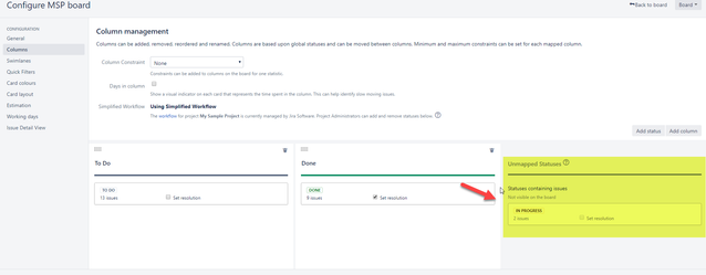

column.pngOnce the columns you dont want are deleted, you will see all the unmapped statuses in the right hand side.
column1.pngYou should then be able to drag the statuses to the columns that you want and your board should only display those columns. You can also leave statuses unmapped, but keep in mind that they wont show up in the board.column2.png
