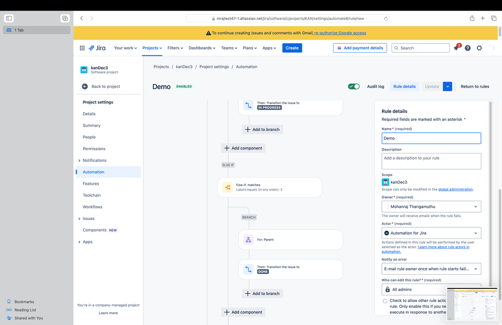

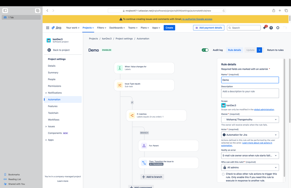

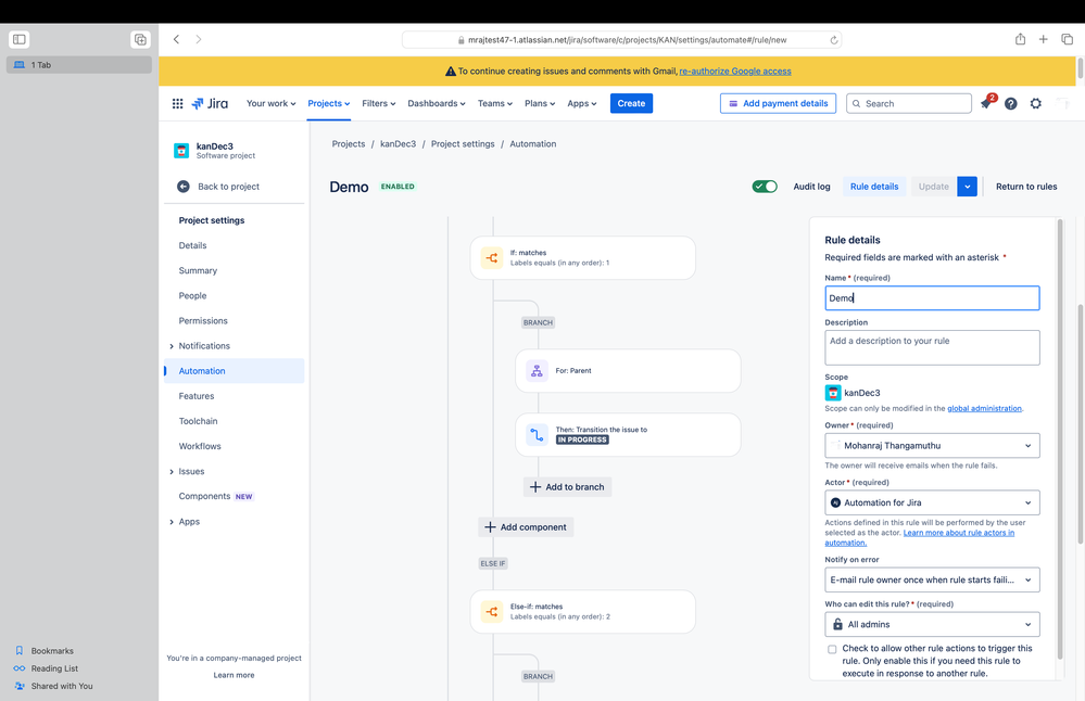

我配置了一个自动化流程,但是也不生效,在子流程中配置条件和后置也不行
Mohanraj Thangamuthu
January 23, 2025
Hello, Good day. I have used label field update as an example in sub-task issue type. Please refer to the screenshots.
Screenshot 2025-01-24 at 11.45.34 AM.pngScreenshot 2025-01-24 at 11.45.42 AM.pngScreenshot 2025-01-24 at 11.45.45 AM.png
