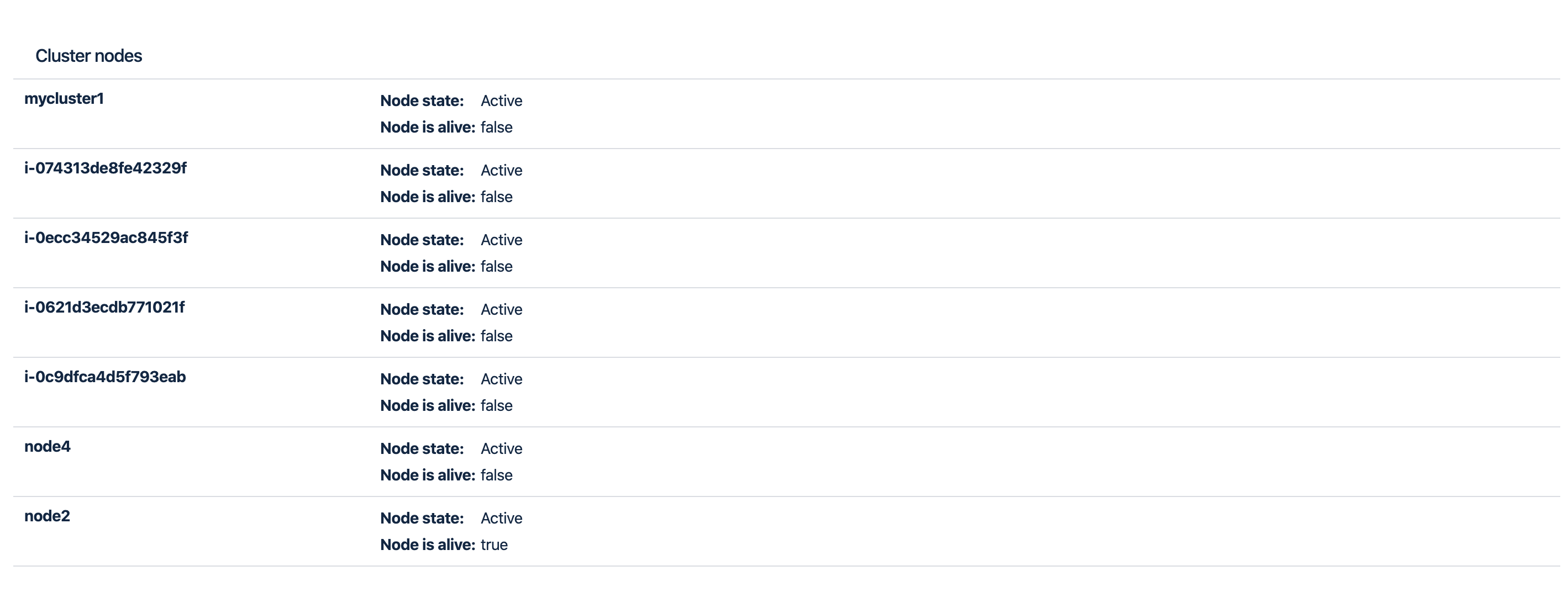

I had to prepare Atlassian Jira Data Center environment for performance testing according to this guide. One of the steps is to restore Atlassian backup to the Jira environment. After I restored the backup my log was full of java.rmi.ConnectException: Connection refused to host and I could connect to Atlassian Jira only using the recovery_admin user.

... 15 moreWhen I tried to login the login form hanged for a couple of minutes and then threw the incorrect user or password error.
I investigated the problem and discovered that I had more nodes than it was supposed to be:
I deleted the wrong nodes from the clusternode table:
delete FROM "clusternode" where node_id in ('mycluster1', 'i-074313de8fe42329f', 'i-0ecc34529ac845f3f' , 'i-0621d3ecdb771021f', 'i-0c9dfca4d5f793eab')After it the error disappeared and I could connect to Jira.
Hope it will help you to solve this error.
