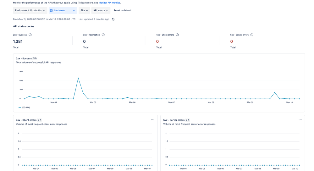

The Forge Metrics Dashboard
Inside the Forge Developer Console, Atlassian provides a metrics dashboard where vendors can monitor app performance.
You can view:
  • Invocation count
  • Invocation success rate
  • Invocation errors
  • Invocation response time
  • API metrics
  • usage metrics (compute, storage, logs)
These metrics help you understand how your app behaves across all installations.

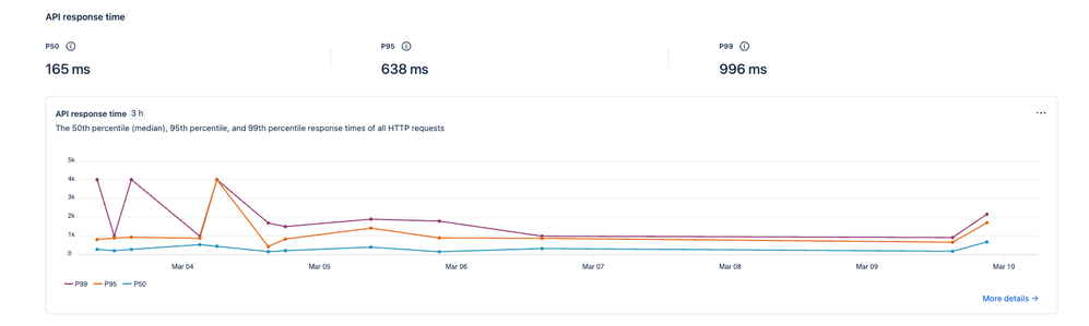

Understanding Latency Percentiles
Forge metrics also display latency percentiles, which show how fast your functions execute.
These are commonly shown as:
P50 - Median Response Time
P50 represents the median execution time.
This means:
50% of all function invocations complete faster than this 165ms.
This metric represents the typical performance of your app.
For Forge apps:
  • <150 ms is typically excellent.
P95 - Heavy Execution Range
P95 means:
95% of all invocations complete within a certain time.
Only 5% of requests take longer.
Higher P95 values usually indicate:
  • heavier database or storage reads
  • large data processing
  • complex API interactions
P99 - Worst Case Performance
P99 represents the slowest executions.
Only 1% of requests are slower than this value.
These often occur during:
  • cold starts
  • large payload processing
  • external API delays
  • retries or heavy computations
