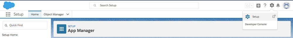

To create a connected app go to cog wheel -> Setup:

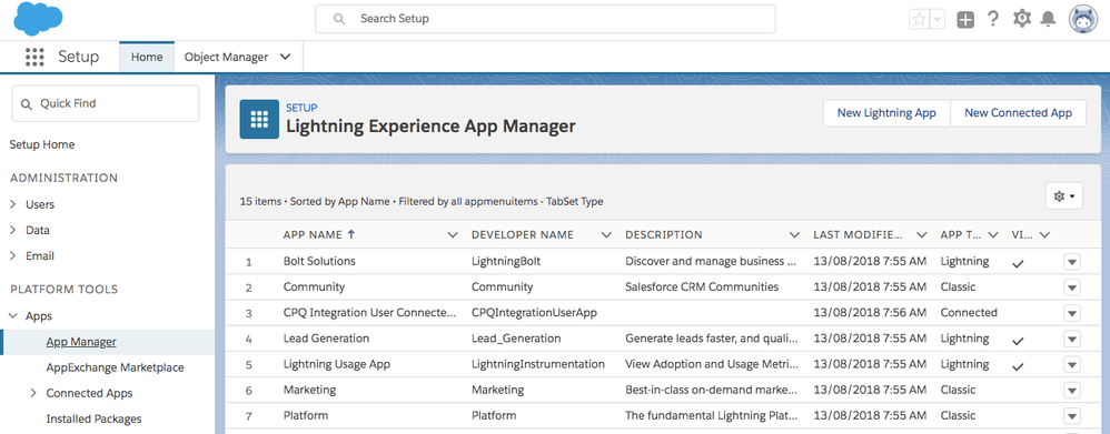

Choose App -> App Manager:

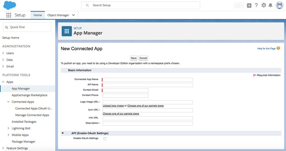

Push the New Connected App button:
Click the checkbox to enable OAuth settings. The callback URL is not used in the integration. Select Full Access and click Add. Then click Save.
On the next page, under OAuth Settings, you'll see your Consumer Key and the option to reveal and get your Consumer Secret

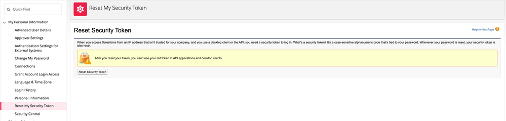

Also you need to get your user secret token in Salesforce.
To get the security token of a user. Go to User Settings → Reset My Security Token. Reset the security token and you will receive a new security token to the user email address:

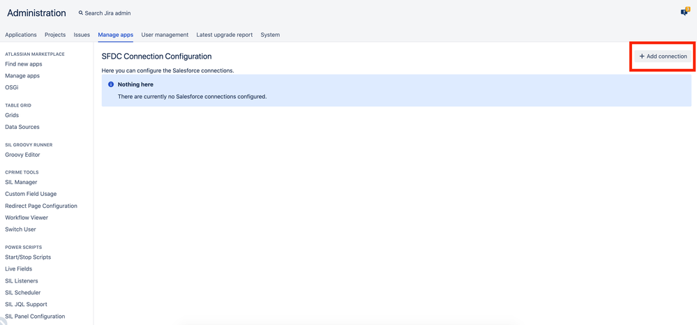

Suppose, that you want to use the Power Salesforce Connector. First install it to you Jira instance and open cog wheel -> manage apps -> SFDC Connection Configuration:

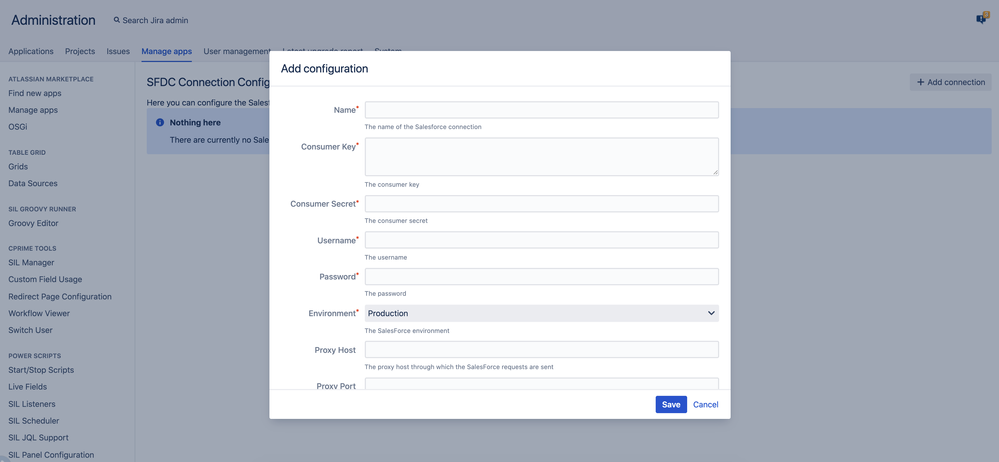

Push the Add connection button:
Fill the required fields and push the Save button.
