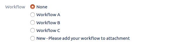

To achieve this in a proper manner, if your organization uses JIRA to support development teams, internal users who are using JIRA projects to manage their products, then I recommend that you create a special project, for example JIRA-Refinement(JIR) that users could create request ticket in this project for the creation of new Jira projects by the JIRA administrator. You can add the workflow field on the create issue screen for example
From the image above, you can see that users need to choose already existing ones or new workflow, most times already existing ones are being choosing since you have already discussed with various teams regarding workflows A, B and C; if at all they choose new, then they would need to add attachment to show a vivid picture on how the workflow should look like. Check whether or not the workflow which they have requested for already exist without any special settings in workflow, then reuse it this way you keep workflows compact. Note that when you create a new project in JIRA default work is automatically added. Thus, you will need to change the workflow / workflow scheme in this project. Default workflow for the project will move to inactive workflow / workflow schemes :) we know how to remove them !
