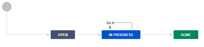

This is very different from a transition that returns to the same status. In the image below, you see a very simple workflow: Open → In Progress → Done. I have added a transition from In Progress back to itself called “Do It”.
This is a very standard way to allow execution of a set of post-functions without changing the status. You have probably implemented this dozens of times in your own environment. The problem with this solution is that it only works from the “In Progress” status. You can’t run it from Open or Done.
You could implement the same transition on Open and Done as well, but then you have three transitions that you have to maintain instead of one. If you have a more complex workflow with 8 or 10 steps, this approach quickly turns into a nightmare.

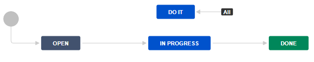

For our purposes, we are going to use the workflow that we created above. Instead of having the “Do It” transition go from “In Progress” to itself, we are going to create a new Status called “Do It” indicating that all statuses can transition to this one.
Notice that if you left this workflow as is, you could never exit the “Do It” status. Our next steps will solve that.

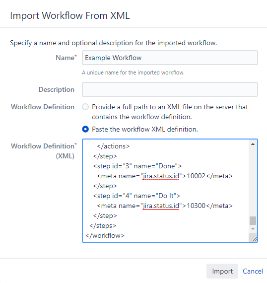

Import the XML as a new workflow
Now you are ready to import the workflow. Go to the Workflows page and “Import As XML”
You will need to give your workflow a new name since the name you used is already taken.
Select the “Paste the workflow XML definition” option and paste in the XML from your editor, as shown above.

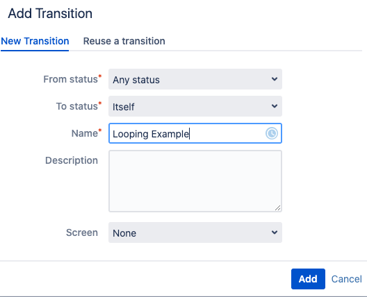

I thought that adding looping transitions was possible in the Jira admin UI though? In Data Center 8.5 I seem to be able to use the graphical editor and Add a Transition as below. Did I miss something?
Christian Pascher
June 25, 2020
@Matt Doar yes, you are right. This way of transition is available if you click in the graphical configuration of the UI on the button to add a transition since forever.
