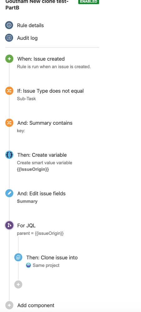

Thank you very much @Jorge H .
I could successfully run Part 1 . But my Part B is not triggering at all. I checked all the values properly. Only difference is I am using Epic Link instead of Parent.

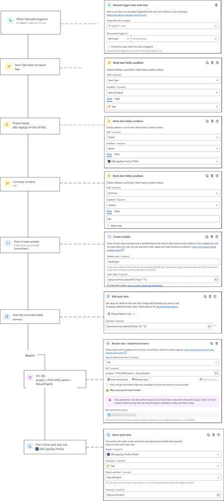

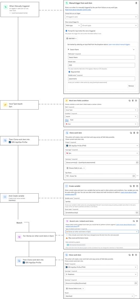

Attached is screenshot showing the details of each section of the flow for Part 1 and 2. Part 1 works and I get epic and its stories (in my case they are work types "Readiness" but think of it just like a story). I can even see where it is leaving behind your fix for injecting key:XXXXX in the "Readiness" work items name when it stands them up in the destination project. SO I believe the issue is in part2 just not able to see those items because its out of scope or some other reason.
THANK YOU SO MUCH FOR THE QUICK HELP!
Part 1 & 2 attached.
PART 1
PART 2
Guy Anela
October 21, 2025
Hi @Timothy Roberts - Just to confirm, are both PART 1 and PART 2 being executed within the same Project (e.g. PTAX)? If not, I would start with executing them within the same PTAX Project so you can confirm whether or not it's a Scope issue. You'll want to make sure that ALL of the items you're cloning (e.g. Epic, Stories, Tasks, Sub-tasks, etc.) ALL belong to the same PTAX Project as well (Again, for Scope reasons).
Hopefully this will at least get PART 2 to execute.
Also, based on your screenshots, it looks like both Rules are triggered Manually. When you execute PART 2, what item(s) are you executing it against? Is it the Readiness items that PART 1 creates? Please explain the execution process.
I would also add some "Log" action items to PART 2 to log the {{IssueOrigin}} smart value variables you're passing (just to make sure you're getting the values you're expecting).   ...if you haven't done so already. :)
Anyhow, let me know how it goes. Cheers!
