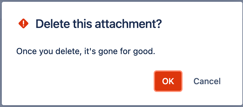

Disclaimer: Please note that deleting attachments is a destructive action that is not recoverable, so take proper care before attempting to use the below method.

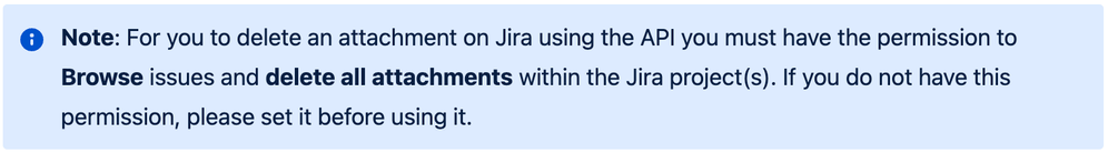

If you have been administrating Jira (Jira Software, Jira Service Management(formerly Jira Service Desk) or Jira Work Management(formerly Jira Core)) for a while you might have come across a time where you’ve stored so much data and storage allocation is almost full and you want to get rid of those old files that are just taking too much space within your cloud instance. This use case employs the use of REST API to perform these tasks. Please note that with automation for Jira, you can perform bulk deletion of attachments by filenames with the limit of 1K issues. However, what you can use this API method factors in additional functions.
  • Delete by users
  • Delete by file extension
  • Delete by file size
  • Delete by date range
  • No issue query limit
All the above is possible with the REST API endpoint provided by Atlassian and by some little scripting, you can get your desired outcome using the API. Also, note that the above method can be used by those administrators who are trying to reduce their attachment size on their instance as well as those administrators who want to automate or even dynamically perform attachment deletion from certain projects at a certain interval. If you would like to automate this process, this API can help you do that just continue reading to find out more.
The other use case surrounds GDPR compliance and how organizations would require to delete personal information from their project. Take, for example, you are an IT Service Desk manager and your organization has a regulation that each customer ticket that is created and has an attachment in it should be deleted within 60 - 90 days. If your project has been running for the past 2 or more years and you’ve got over 40K to 50K tickets. How do you go about finding every attachment and subsequently deleting each one or how do you separate deletion of attachments by certain customers who want their data deleted from your ticket?
Oh! you’re still waiting for an answer. Well, the simple fact is that it is possible to do all that. I will show you how you can achieve all that within your Jira projects and be GDPR compliant in terms of removing user-generated content that contains personal or identifiable details. I’ll also show you the basic usage of this API and how you can even integrate it within your local system (macOS or Linux) to perform automatic attachment deletion on a regular interval using cron jobs.
There are two methods when it comes to deleting attachments using this API. I will simplify the process here to make it as straightforward as possible. It is either you use the file method or the search method. For this use case, we’ll be using python as our scripting language and a library called jiraone which can be downloaded using pip install jiraone or python3 -m pip install jiraone

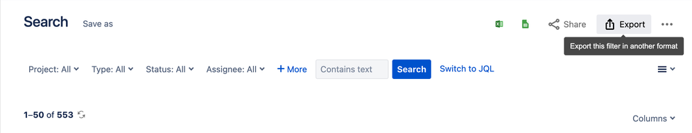

Using File Method
Subsequently, if you do not want to run a search, you can perform an entire export of your filter query from your Jira UI by navigating to your Filter > Advanced issue search, typing your query to get the desired result and click the export CSV all fields.
You do not have to edit the file or change the format in any way. If you’ve exported it as an xlsx file or you’ve modified the file by removing other columns. Please add a delimiter argument and use “;” as the delimiter. Always ensure that the headers are present and not removed. Also, ensure that the “Attachment” and “Issue key” columns are always present in the file.

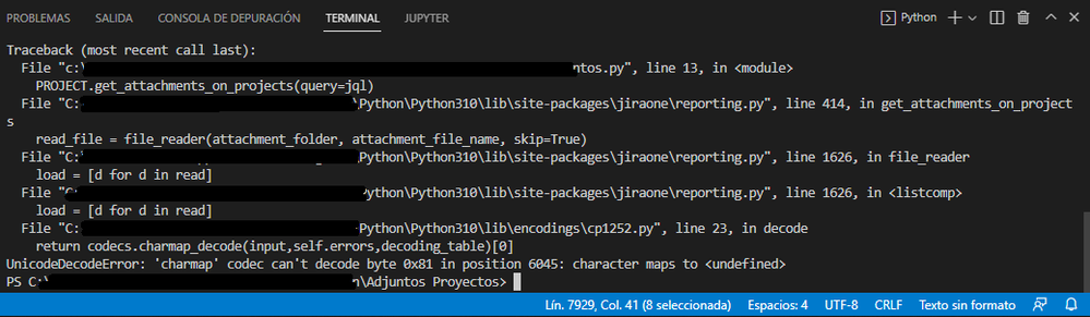

The information you share with me in the previous comment is very helpful, I'm working as you mentioned it and it seems to work only that I have a problem, I can't get all the information because I get the following error: UnicodeDecodeError: 'charmap' codec can't decode byte 0x81 in position 6045: character maps to <undefined>
Can you help me with this error?
I currently have the following versions:
Python 3.10.3
Jiraone 0.6.3
Pip 22.1.2
I hope you can help me, I will thank you so much.
Prince Nyeche
July 2, 2022
I think I know what the problem might be. It seems to be a character encoding with windows system, it has to be explicit when reading files too. I'll push an update to v0.6.4 soon. As I have new features that comes with that update.

Thank you so much for your reply. I will be on the lookout for the update.

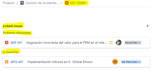

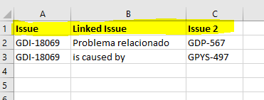

I wanted to ask you if with Jiraone we can obtain a report that shows us all the Linked issues
to all the issues of a project.
I have tried several options, but I don't get anything favorable. Do you know if with Jiraone I can get a report similar to the following?
I hope you can help me, I will be very grateful.
I await your comments.
Best regards.

I don't have this yet on jiraone but a report can be constructed with jiraone by calling multiple APIs but I think you're referring to a simple call or function to get this kind of report data. If that's the case, I can add work log data as part of an additional feature report but all those might be in the future updates. Probably from v0.6.5 and above. Please can you create a request here, that way I can keep it in view?
About the update from before. I've been caught up in other tasks but I should have v0.6.4 updated before the end of this week.

About the previous issue, you can download the latest version of jiraone to fix that problem. Let me know how that goes.

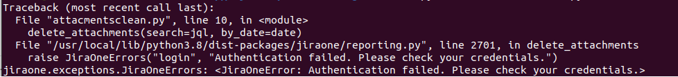

Kirill
March 7, 2023
Please help me. My account has administrator rights , I got it . Why do I have such an error ?1.png
Prince Nyeche
March 7, 2023
Hey @Kirill
The error shows that you're not authenticated. This means probably the way you've connected might not be valid. Are you connecting to a Jira cloud or Jira Server/DC?

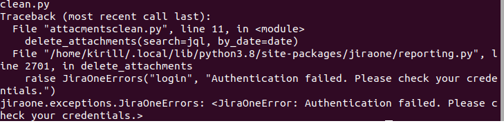

Kirill
March 7, 2023
Jira 9.4.0 installed on our local server.
Prince Nyeche
March 7, 2023
Hey @Kirill
Add this line LOGIN.api = False to your script.
from jiraone import LOGIN, delete_attachments
import json
config = json.load(open('config.json'))
LOGIN.api = False
LOGIN(**config)
Then attempt your connection again.
Kirill
March 7, 2023

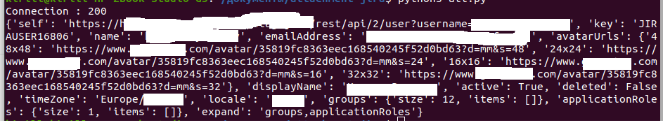

Prince Nyeche
March 7, 2023
Okay, let's take a step back here and see if everything with your actual login is true. Use the below script
from jiraone import LOGIN, endpoint
import json
LOGIN.api = False
LOGIN(**config)
output = LOGIN.get(endpoint.myself())
print("Connection:", output.status_code, output.reason)
print(output.json())

Kirill
March 7, 2023
Prince Nyeche
March 7, 2023
