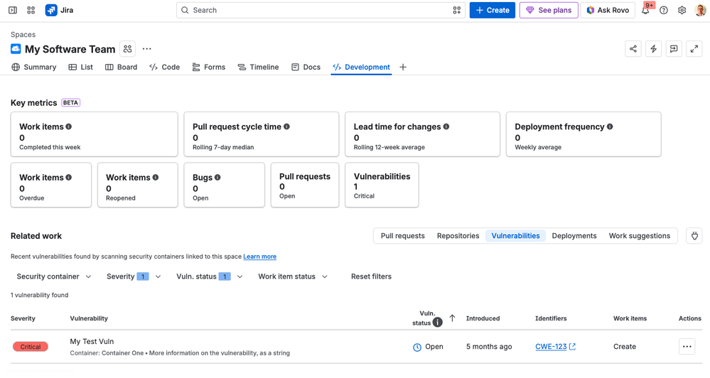

What is a Security Info Provider?
A Security Info Provider app surfaces vulnerability information to a Jira space. Vulnerabilities appear in the Development tab for a Jira Software space.
From here customers can create a new work item for that vulnerability, or link the vulnerability to an existing work item. This helps them see new vulnerabilities that your app detected, and helps them track the progress of the work to address that vulnerability in Jira.

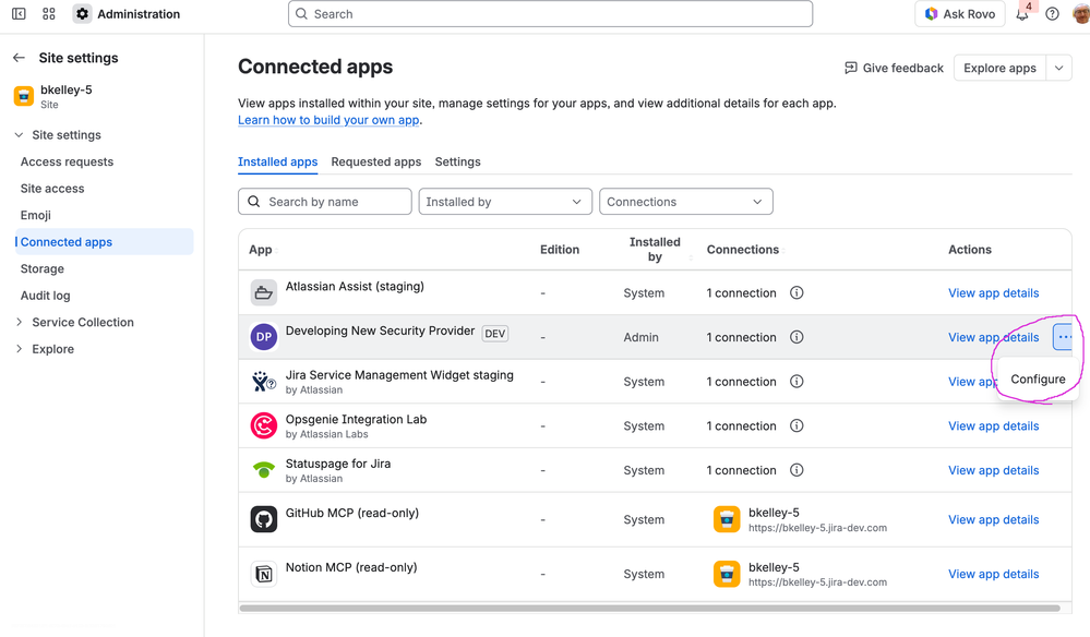

Now in Jira click the “…” next to Apps in the menu and choose Manage Apps. (At the moment in June 2026 you will get a page telling you that App management has moved to Administration, so click Take me there. Click the “…” to the right of your app, and click configure.)

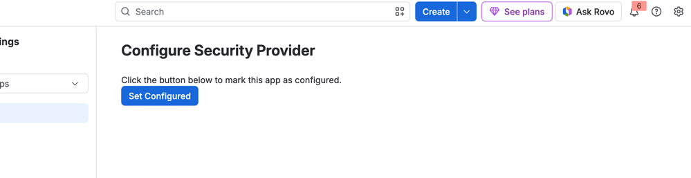

You should see the configuration screen we defined earlier.
Clicking Set Configured should cause the application property to be set. Because I built a lightweight admin screen, I have no way of knowing if it worked, so I went into “Download logs” from the View app details screen.

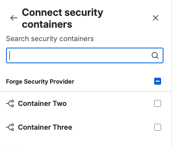

After deploying and updating your app (and starting your app’s back end), go to a Jira Software space in the Jira UI. If your space doesn’t show the Development tab, click the + to add the Development tab. Then click Vulnerabilities. It will tell you that you need to finish setting up your security apps.
Clicking Finish Setup should show your security app name on the right column.
If you have not already set the isConfigured application property (using the UI we made earlier), there will be a button that will take you to that admin page to set it.
After that, assuming your app created some linked workspace IDs, Jira will call your app’s fetchWorkspaces endpoint to get the names of those workspaces, and they should appear in the UI.
If you click on the workspace, Jira will call your app’s searchContainers endpoint (and fetchContainers endpoint) to find out about containers in that workspace.
You should be able to check the box and click Connect.

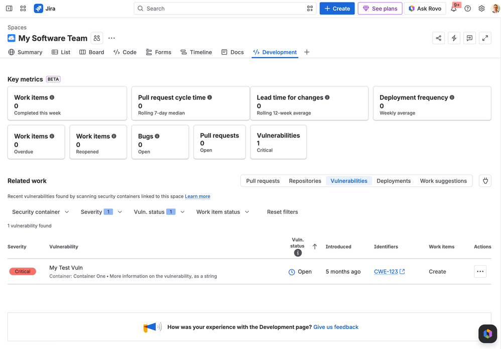

Sending vulnerabilities
Now your app can send vulnerability data to Jira, and have it appear in the UI. If the container ID in the vulnerability matches a container that the customer linked to their software space, then the vulnerability will be visible.
See the API documentation on submitting a vulnerability.
As with submitting workspace IDs your client will need to look up the authentication token and API base URL if submitting the request from your app’s back end. (The Forge Bridge API looks this up automatically if you submit from the app’s front end.)
I won’t detail the client code here, but it is very similar to the client for submitting workspace IDs. The scope requirements are the same.
Testing

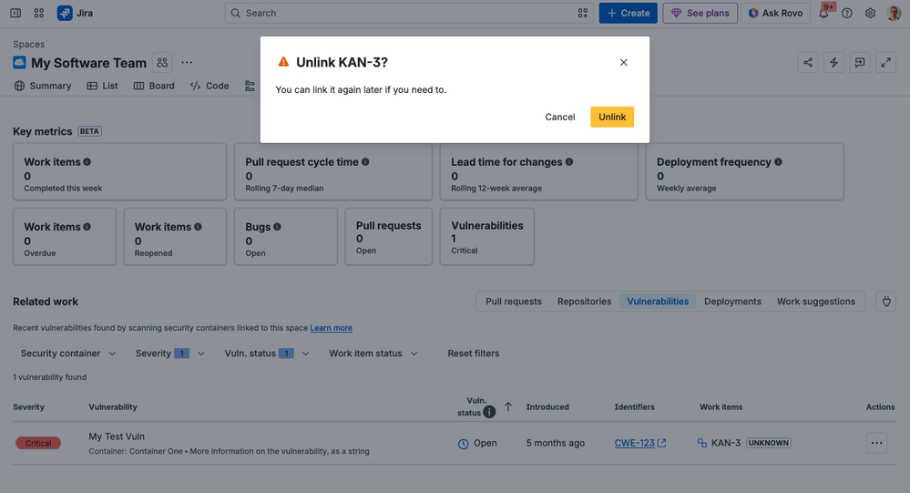

Go into your Jira Software space and link a workspace and container.
Now submit a vulnerability where the container ID matches the container you linked in the UI. You should see it in the Vulnerabilities section in the Development tab.
If you click the “…” in the Actions column you can link a work item to this vulnerability (or click Create to create a new one). You should see a call to your onEntityAssociated endpoint. If you then unlink it you will get a call to your onEntityDisassociated endpoint.
