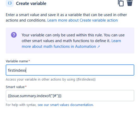

1) create a container variable

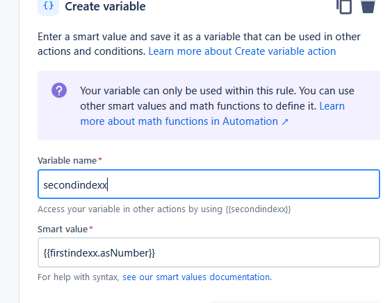

2) make sure it's a numeric:

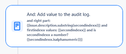

3) extract a part of the description (it's a long string). I also tried the function "issue.summary.right()", with the same result

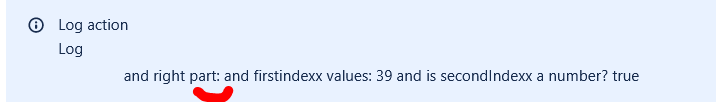

4) check the logs: no text has been read, as if issue.description.substring() wouldn't work with a smart variable as parameter. When I input an explicit integer like 5, it works. With the smart values, it doesn't. As you see in the logs, I made sure the value is a numerical.

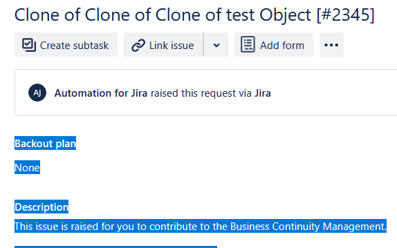

PS: this is the ticket I use for testing purposes, how it looks like. As you see, summary and description are far from being empty:

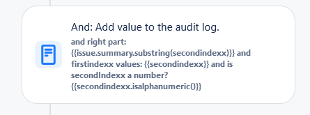

I know issue.description is in the automation action while the issue.summary is used for the temporary values, but that is no error cause. I tried it with issue.description to compare with issue.summary. But this doesn't play any role. Here is how it looks like when splitting the issue.summary. same (unsuccessful) result:
