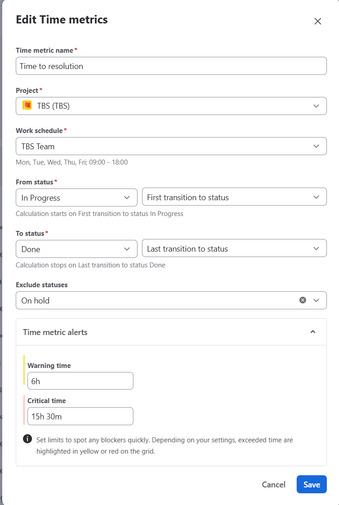

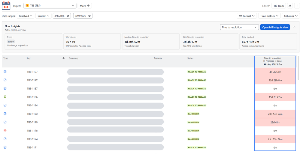

If you want resolution time for every ticket individually rather than a single average, use a report grid — one that shows one row per issue with the duration calculated for each, not an aggregate.
For this I'd recommend our app Time Metrics Tracker | Time Between Statuses. You create a Resolution Time metric: pick the status that starts the timer (e.g. when a ticket is opened) and the one that stops it (resolved or Done). You can exclude statuses that shouldn't count — like "Waiting for Customer" — and link a Work schedule so idle time over weekends or holidays doesn't count.
The grid then shows each ticket as its own row with its resolution time, so you can sort to find the slowest ones, filter by date or assignee, and export to CSV/Excel

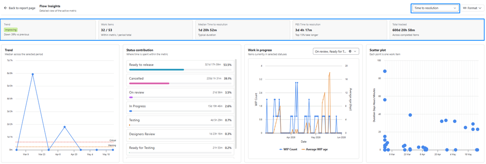

The same metric also feeds Flow Insights above the grid if you want a quick read on trends and which status contributes most — without exporting anything.

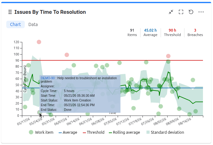

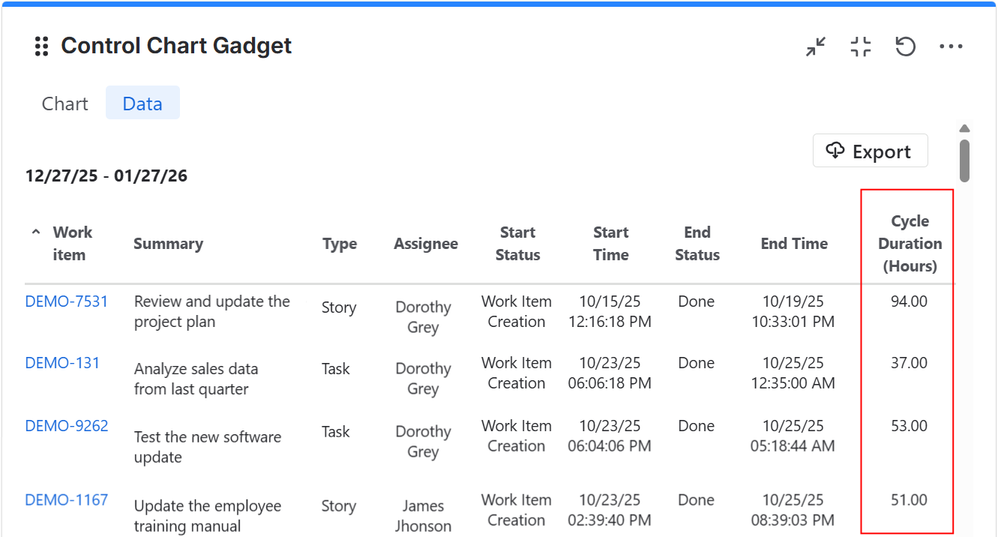

Hi @Nugzari Turashvili,

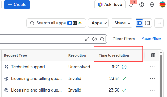

Jira Service Management has a Time to Resolution column that you can add in your filter result screen.  But the value it displays is actually "remaining time against the SLA goal". Is this what you need?
If you are looking for how long an issue actually took to be resolved, then that is a completely different metric. In this case, as already suggested, you could try adding a custom field or exporting the data and calculating the resolution time in Excel. Alternatively, an easier option would be to look for an app on the Atlassian Marketplace.
If you are willing to try an app, our Great Gadgets app offers several gadgets that can calculate the time to resolution. For example, the Control Chart gadget can be configured to calculate and display issues based on their resolution time.
In addition, its Data tab provides a detailed report listing all the issues along with their duration, representing the time to resolution. It highlights SLA breaches in red-color.
The app offers some other gadgets that can display issues by their time to resolution. See more details in this article: https://community.atlassian.com/forums/App-Central-articles/An-effective-dashboard-for-Service-Desk-and-Customer-Support/ba-p/2360369
Hope this helps.

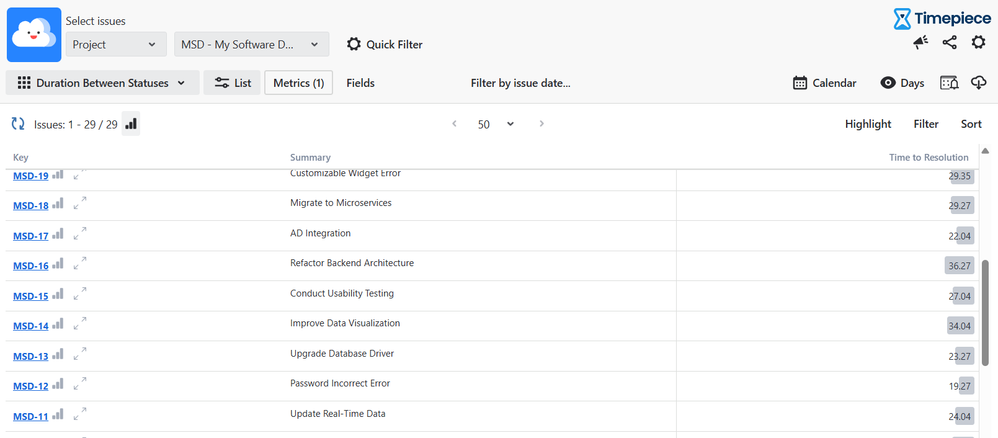

Timepiece - Time in Status for Jira solves this exact problem by letting you shift from high-level aggregates to detailed, issue-by-issue clarity in just one click.
How does Timepiece solve the problem?
Well, instead of showing you a single rolled-up number, Timepiece can track the full lifecycle of each issue. Here is how simple it is:
 Define Your Scope: Choose your target project or sprint.
Use the Duration Between Statuses Report: Set your metric to count from "Issue Creation" to "Resolved/Closed".
Switch from Average to List: Next to your report type, locate the List / Aggregation menu and select List.
This instantly generates a clean table displaying every single ticket in its own row alongside its precise resolution time.
No complex JQL, no fragile automation rules, and no manual Excel exports required.

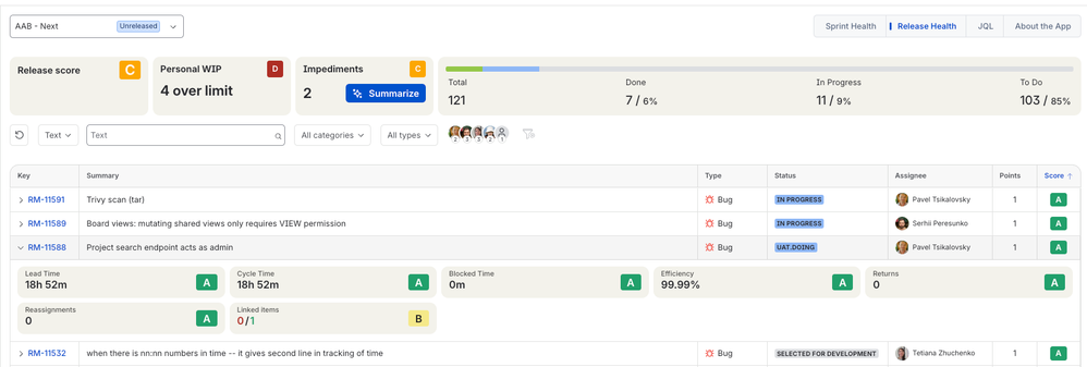

Hi @James Gamble
I believe you have raised a quite hot topic :)

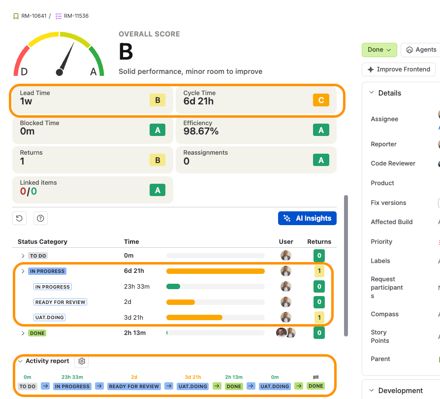

You can also suggest checking out our app, which provides a summary and assigns a health score to each issue based on multiple criteria.
The report works on issue level or across multiple work items based on the Sprint, Release, or JQL query.
Thanks,
Yuri
