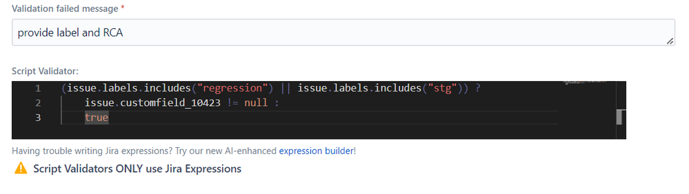

From my POV, I think you should fix it as issue.labels.includes and use the workflow validator as here:
(issue.labels.includes("regression") || issue.labels.includes("stg")) ?
    issue.customfield_10423 != null :
    true

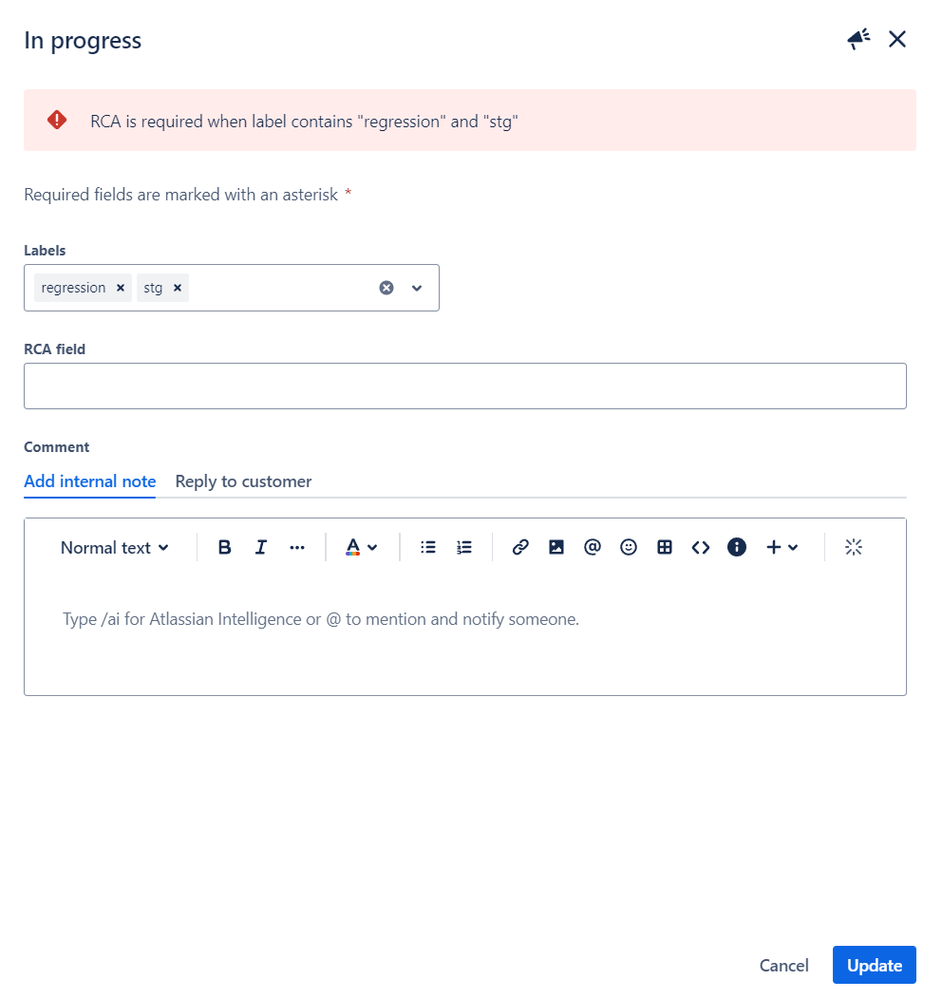

For status B doesn't appear on option list is maybe because you might have set up the workflow condition instead of validator.chrome_m7QjH3RXYG.pngchrome_58iBWtcoP3.png
I hope this can help and meet your requirement

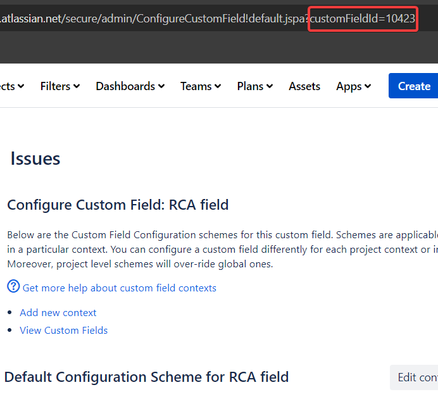

2. the below line you wrote, represent the RCA field that i want to make sure is not null? how do i know the field ID ('customfield_10423') for other fields?

2. You can check customfield id by go to Settings > Issues > Custom fields > *Edit context* > You'll see a row of number on the URL
