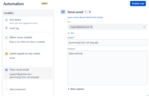

I might instead suggest you initiate the prosess by creating an issue directly on your internal Jira and have an automation triggered by Issue created. Within that rule you send an email to your partner and make sure the subject contains the issue key. Something like this
{{summary}} (our ref: {{issue}}
Just make sure the rule sends email to your partner only on prefered issues, i.e, apply a filter for a label, a component or a customfield etc. In example you an add a label "external-parnerxyz" and have a rule filter for that.

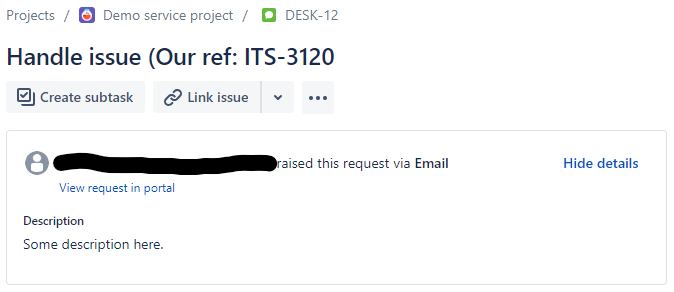

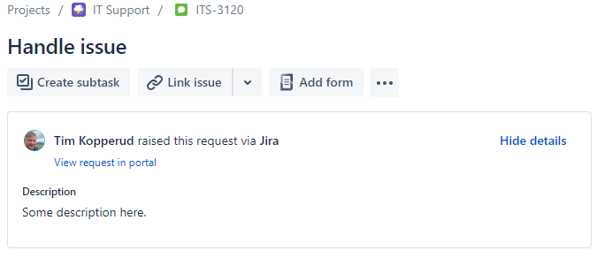

Yes. Here is an example of such automation rule:
Result at partner:
Your side:
I did vote for @Ste Wright answer though, because email is seldom a good option for syncing data. There are many ways to sync between Jira instances, and sync method it often depending on the degree of your collaboration. But my answer is based on scenarios where email is the only option.
