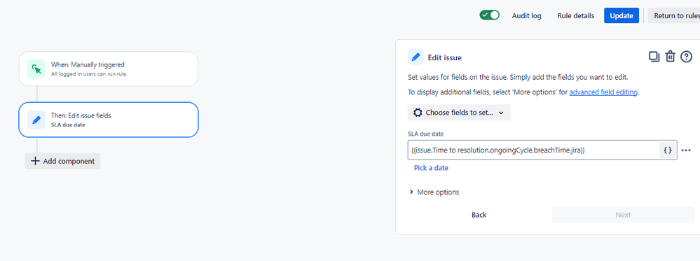

Hi @Sonika Maddinapudi
With Automation, you can use this smart value to update a custom field
  • {issue.SLA_NAME.ongoingCycle.breachTime.jira}}
Example for Time to resolution SLA
{issue.Time to resolution.ongoingCycle.breachTime.jira}}
