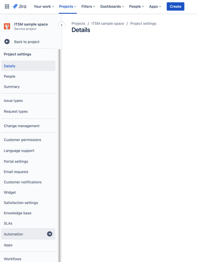

To get to the "right" automation, first you'll open the Project Settings, and click Automation most of the way down the left sidebar:

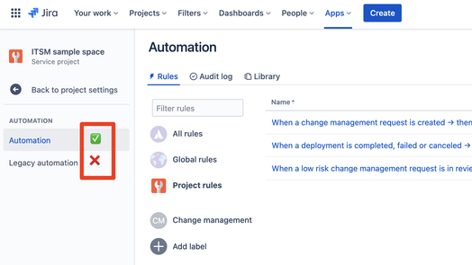

From here, things can get off-kilter. You should see two options on the left, one for Automation (the one you want to use), and Legacy automation (the one you don't want to use):

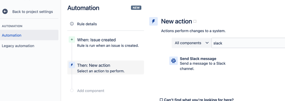

When creating a rule in the Automation (not legacy), you can create a trigger for Issue Created, then an action for Send Slack message.
This allows you to send a message with the Slack webhook URL. You do not need to format the message payload like you would with a normal webhook, as Automation takes care of all that for you.

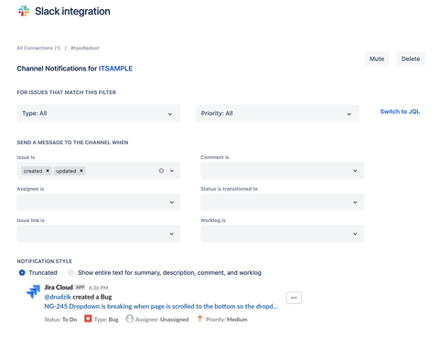

The other method is using the built-in Jira Cloud for Slack app, which is also free. You can use the app to create subscriptions into Slack channels when certain triggers happen in Jira. Here's an example of a basic rule that sends a notification when issues are created or updated:
Getting set up with the Slack integration is pretty straightforward - you can install the app in your Slack workspace and the Jira Cloud bot will guide you through the rest of the configuration.
