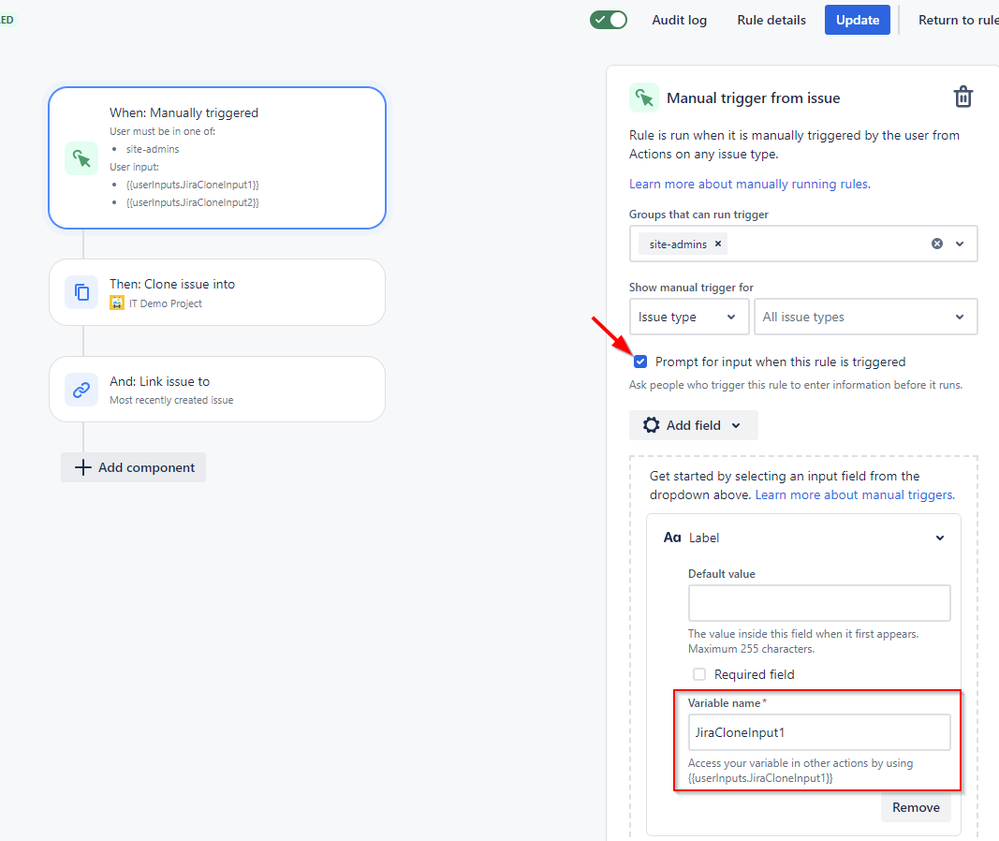

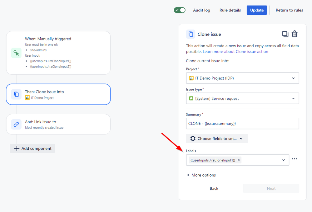

I have successfully cloned an issue using the action trigger in Jira Automation, and also linked the cloned issue from where it was created. This way I am able to preserve more field values than using the regular "create linked issue".
My issue now is that the request types are different and I need to set the request type. I want to set the new request type based on input variable using "Prompt for input when this rule is triggered".
I am having trouble finding the correct action to do this or can it be done even?

Per Lofgren
January 3, 2024
Hi Marc,
Thanks for your answer.
There is an option to prompt for input and I have successfully manage to set the label for example on the cloned issue based on user input.
What I need to do is set the request type since the request type does not match in the other JSM project
