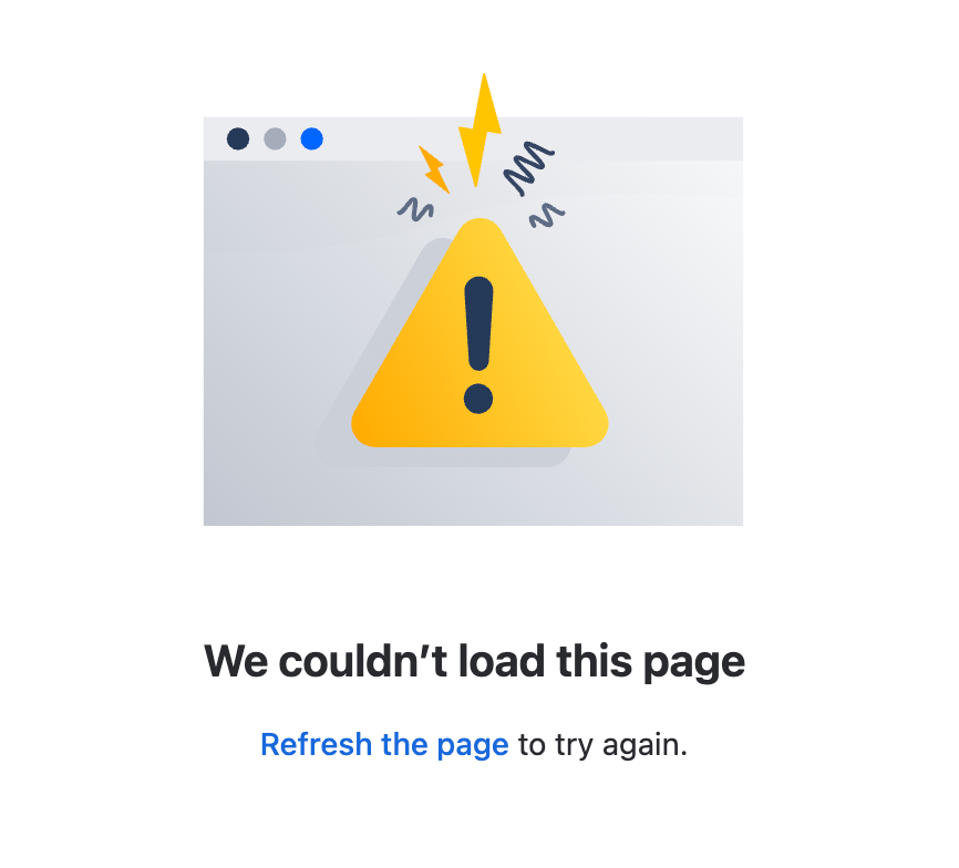

I just finished setup customer portal, and decided to test. Opened customer portal in incognito mode, logged in and immediately "we couldn't load this page" error occured.
  • Checked the permisions - they're OK.
  • Tried different browsers - no change.
  • Tried different accounts to login with - no change.
  • Tried different IP's - no change.
  • Tried clean the cache - no change.
  • Works ONLY if I logged in as an admin/agent, not as customer.
And do not know what to do else... Please, help.

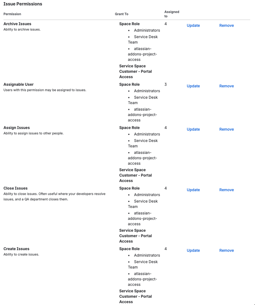

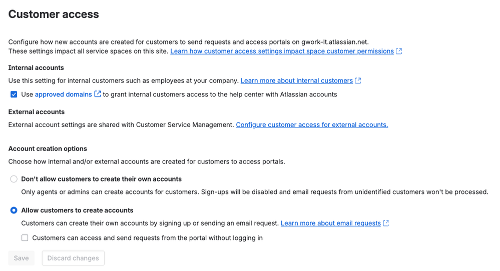

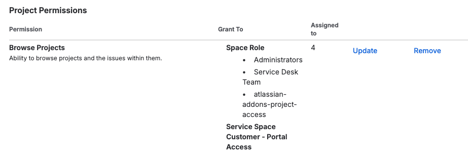

Check your global Customer access settings and the project's Customer permissions to ensure the portal isn't restricted. It is also worth testing the direct project portal URL instead of the main help center hub.
If it still fails for all customers, grab a browser HAR file and contact Atlassian support to look for a backend error.

Just checked, looks like everything is on its place, screenshots below.
Ok, taking the har files and trying to contact support.. Thanks for your input!
Screenshot 2026-05-21 at 13.40.37.pngScreenshot 2026-05-21 at 13.40.12.pngScreenshot 2026-05-21 at 13.39.45.png

Support helped me. The issue was simple: “*Allow customers to get support in Jira Service Management*” was turned off. It must be enabled for portal-only customers to access the site. If this is off, customers will see "We couldn't load this page" or access errors.
Direct Link: Customer service admin (not sure if the link is universal)
Hope this helps also for others!
