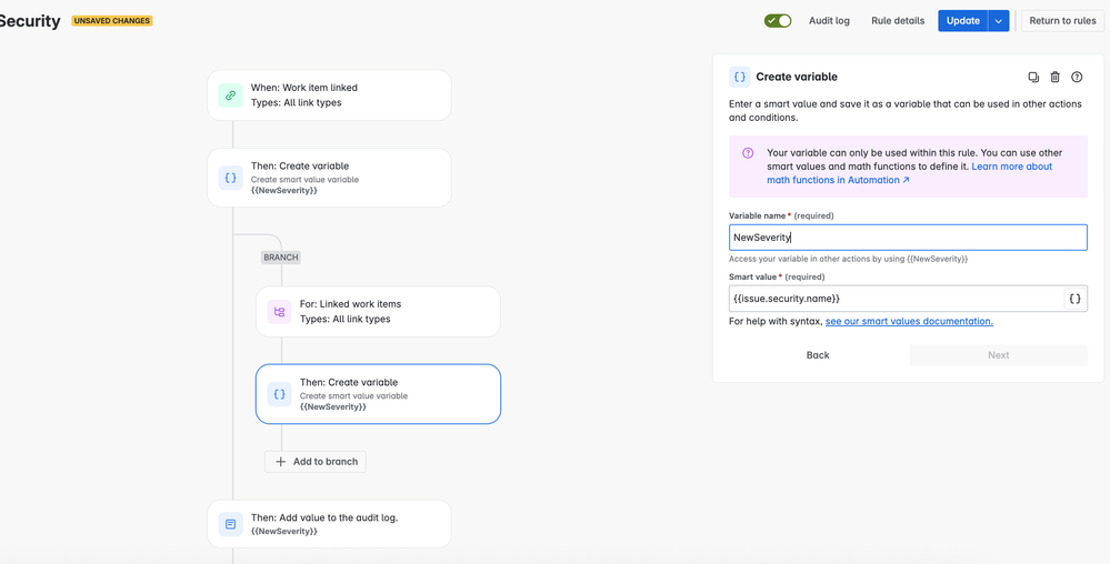

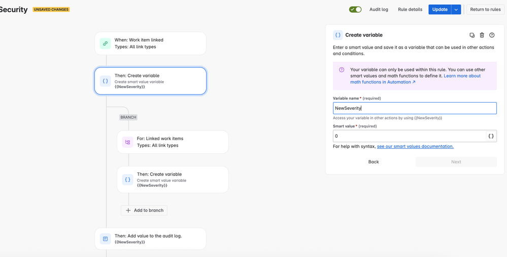

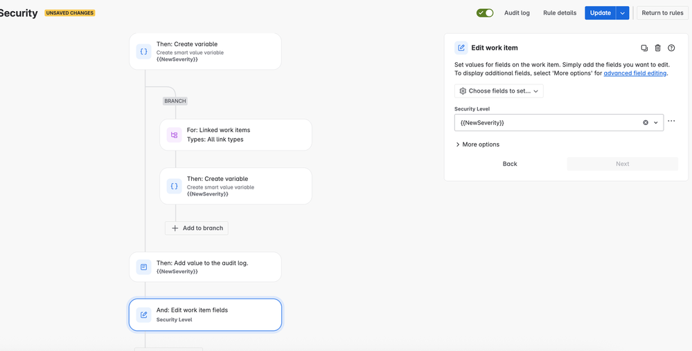

First, make sure that you add to every security level the project role: atlassian-addons-project-access as it will be the one who will run the automation.
arielei
June 8, 2025
Screenshot 2025-06-08 at 19.21.19.pngScreenshot 2025-06-08 at 19.21.30.pngScreenshot 2025-06-08 at 19.21.39.png

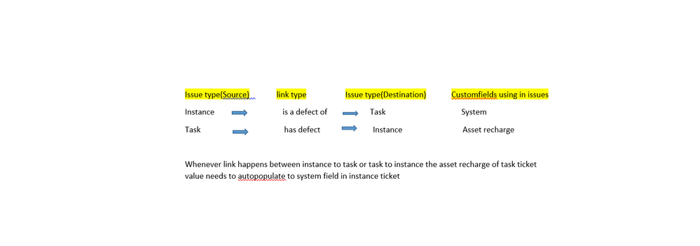

thumuluru.shreya
June 8, 2025
Hi @arielei , please find the screenshot it may be helpful for easy undesratnding if not please let me know
