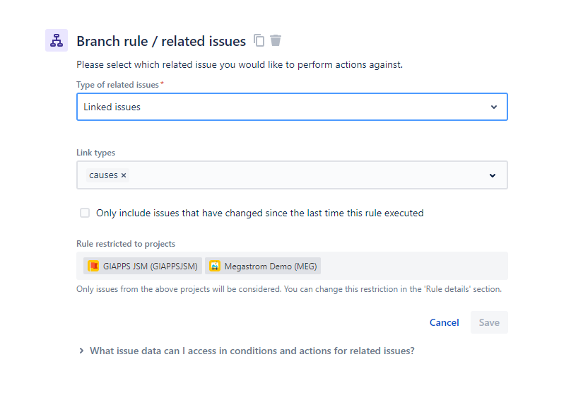

Welcome to the community.  Your rule will be established in the Jira Software project, but it will have to be setup as a global rule and involving both your JSM and JS projects.  You will need to create a "Branch rule/Related issues" setup where you need to reference the linked JSM issue (assuming your 1st rule that creates "clone" the JSM issue into your JS issue already created an issue link setup).   If so, you will conduct an action to edit/transition the linked JSM issue within the "Branch rule/Related issues" setup.

For anyone who might have the same questions, here is the automation that i created to solve my problem:
make the automation global and include both projects, this can be done after a draft of the rule is published and click on "rule details"
1. When value changed -> enter name of the field you want to trigger the automation
2. issue fields condition ->  select the trigger field (same as above field), pick the condition and value you want to trigger the automation
3. JQL condition -> project = "my JSM project" (this project has the issues that will be cloned)
4. clone issue -> select the project where you will send the cloned issue, pick issue type
5. Link issues-> linked issues -> clones -> trigger issues
6. Branch rule / related issues -> linked issues -> clones
7. on one branch select issue fields condition -> status-> is one of -> value=done
on the other branch, transition issue -> statue you want
8. comment on issue
