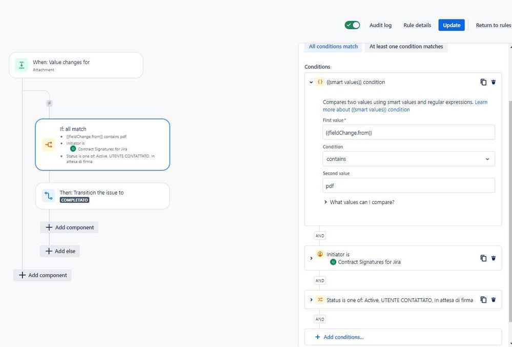

hi @Rudy Holtkamp ,
I just tried as you told me, however it doesn't change the status, where am I wrong?
thank you!
What is the output of the audit log on running the rule?
This should give you a clue?
Unfortunately, the log only says: "The following issues did not match the condition"
