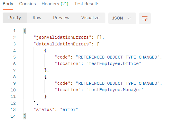

Finally got the import working until I introduced reference attributes. I've updated the schema JSON but when I PATCH using the updated JSON schema I get this error:
{"jsonValidationErrors":[],"dataValidationErrors":[{"code":"REFERENCED_OBJECT_TYPE_CHANGED","location":"testEmployee.Office"},{"code":"REFERENCED_OBJECT_TYPE_CHANGED","location":"testEmployee.Manager"}],"status":"error"}
This is the JSON schema definition I'm using - if I remove the reference attributes then PATCH works:

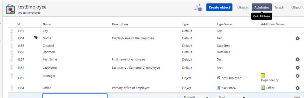

}For reference:
This was my objectType before creating the import mapping:

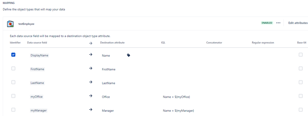

And this was the import mapping created using the above JSON:
