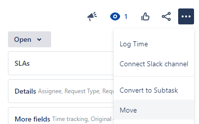

  1. Open the issue, that has the "Emailed request" Request Type active
  2. Clicking the "move" option in additional options under the ticket
  3. You will see the issue ID of the at the end of the URL

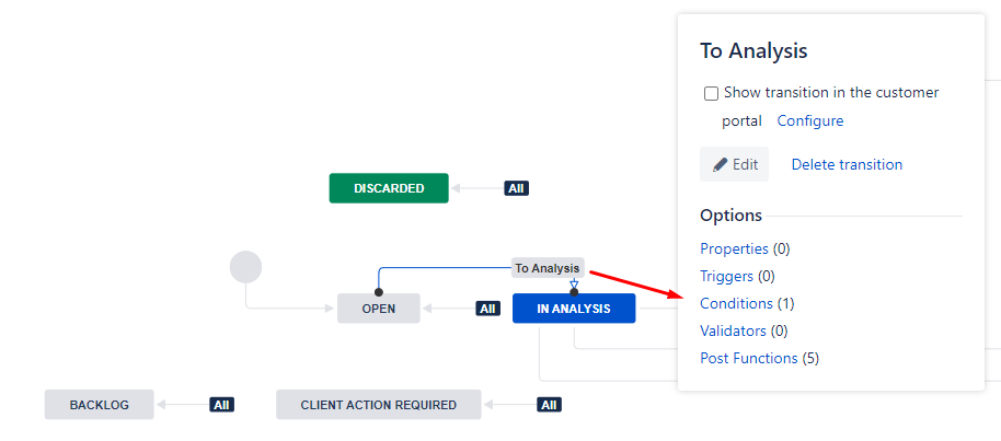

Workflow set up:
For each transition from the "Create" state we will need add a condition, that it cannot transition. This applies to all transition you do not want to be visible in the example below I would set it up for "To Analysis" and all "to All" transition such as the All -> Discarded.
  1. Add a new "Value Field" condition with the following set up
    1. Field: "Customer request type"
    2. Condition: "!=" (Not equal to)
    3. Value: "portalKey/key"
    4. Comparison Type: "Option ID"
Let me know if you have any questions or this solution does not suit you.
